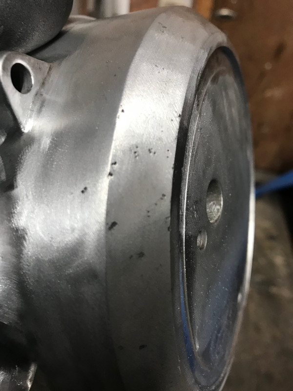

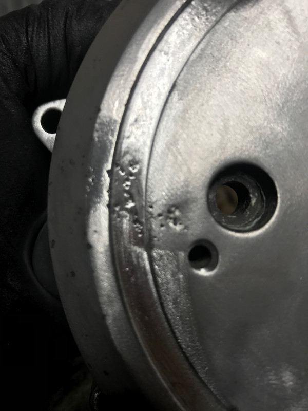

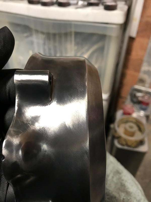

This is the sort of damage I mean, really deep pits, and this is after working on these areas for some time.
Still working on those but they are starting to disappear.

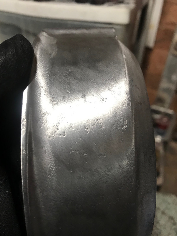

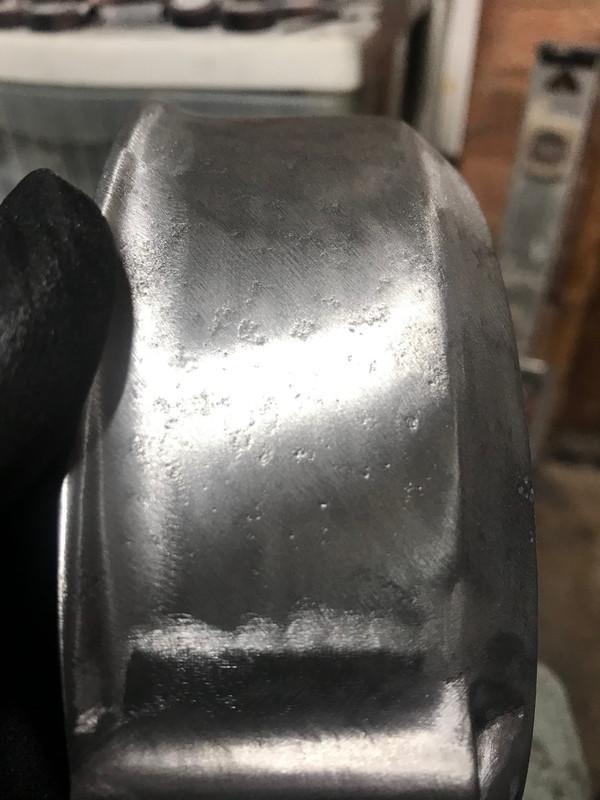

However this post is about the top section of the rotor cover, the bit everyone sees first, the casing has been sanded and this has revealed the damage, top surface usually gets away with a lot but not this time.
Before.
Now professional polishers show pics of damage on their websites BUT they don't tend to show after shots, just carefully posed pics of complete casings without showing where they've completely failed to fix anything, these shots IMO are excuses, here's what you gave us to start with, of course we are not magicians so don't expect a great finish everywhere. Not, this is the damage and look how good we are, it's all gone away.
So this time I thought, lets show before and after pics.

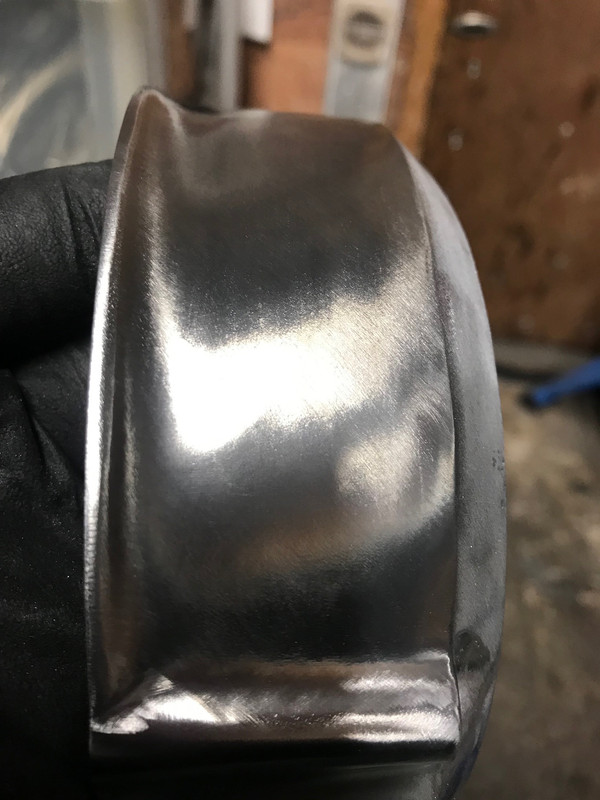

AFTER. 2.5 hours of work on what's essentially an 8 x 1.5 inch piece of alloy. NOT polished, not been anywhere near the polishing machine, just used my new secret weapons and then finished off with some of my more normal brushes, sanded down to 1000 grit.
Now I'm no different from most members on here, if I can do this then so can you, I'm not gifted, I don't have expensive machinery, I do have patience and time and some basic tools, this means you can do the same.
Next is to finish the case, if that's possible and then polish it. I reckon I can get that back to roughly the same condition as the very first pic where it was chromed. After that, I'll probably throw if in a box for a few more years as I already have a decent rotor cover  ;D ;D

Rotor case is almost fully flatted now. 99% of the pits have been removed. Only ones left are where the Honda cover would cover them anyway, I could have removed those but the metal isn't that thick there and I didn't want to ruin the case just as it was getting so close.
Final few sandings tomorrow and then maybe polish it. It's looking pretty good, lovely and flat.

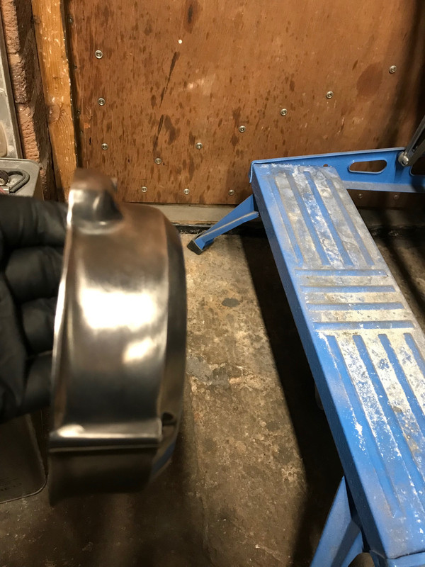

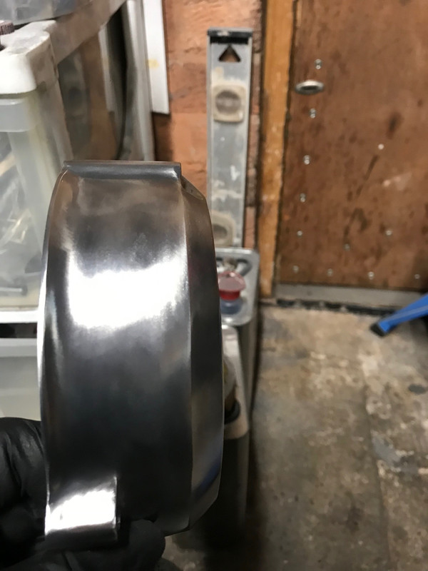

Rotor cover now completely sanded down to 1000 grit.
Ready for polishing. Not sure when I'll have a day or 2 of polishing, need the weather and to feel in the mood. Dirty job, look like a coal miner afterwards..
Front. The only place any pits are left is about 9.47 and 11.55. Both under the cover so not important.
Sides. Tried to do the same angles as the original pic so you can compare between the damage and the finished article.
