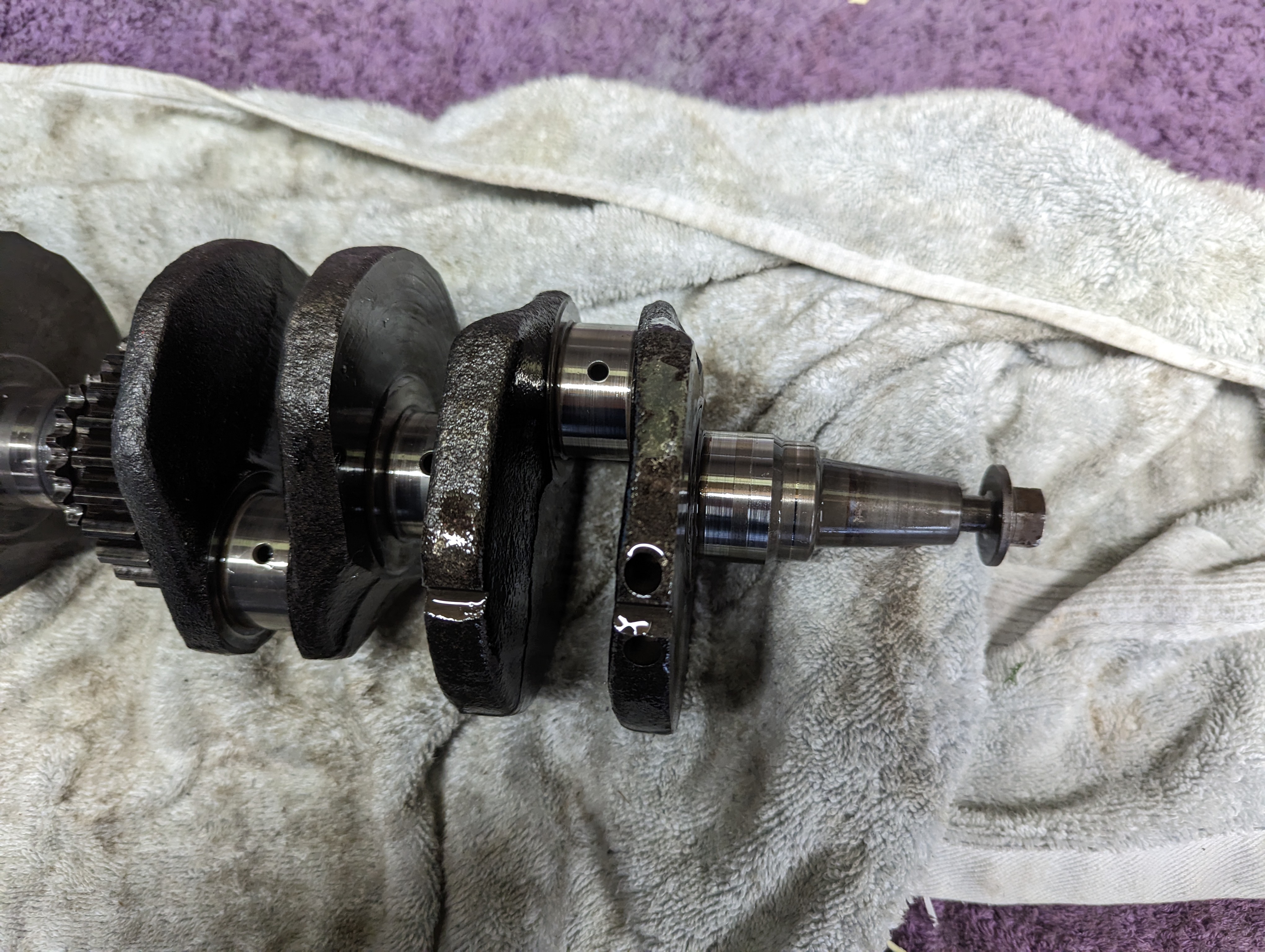

I'm trying to read the codes for the big end shells as there are no big end shell colour codes  visible.
All four webs seem to have the same letter but can't decide if it's an A or a B it looks more like a B.
The conrods for 1,2 & 3 are marked [2] with number 4 conrod marked [3] all have the letter [F] on them.
What are the views here please?
Any advise as to shell colour code welcome.
If its a letter B I'm thinking they would have been 3 x Brown, 1 x Black.
..codes on crank web by Macabe Thiele, on Flickr

The lettering is not visible on my phone but is on my PC - the clearest mark is on number 2 journal RHS web.
  • Posts: 4735
Re: What letters are these on the webs of 1 & 2 cod rod codes?
« Reply #2 on: January 16, 2023, 06:17:22 AM »
Wash the crank with petrol or something that dissolves the oil film. As it dries you stand the best chance of seeing the codes then. Don’t forget it’s letter-number, so as the letters are on the crankcasing at the back it’s the number you need for the mains, that means you need the letter off the crank and the number off the rod to work out the bearing. The letters on the rods should all be the same as it’s the weight code so the crank is balanced.

On the mains shells the colour codes are clearly visible on four of the bearings. I was worried that cleaning the crank with petrol might remove the black letter marks. I guess I've nothing to loose really. I did wonder if using all black shells might be a way forwards. DS has them in stock  for the big ends.

Before you spend any money on shells, I would get that crank measured, especially the right hand side (in your pic) main bearing journal - that centre ridge is very noticeable, even with my eyesight!  The big end journals don't look quite so bad but they have full width shells which can hide the truth.
A normal mic anvil might go on the worn section but even a carefully used digital vernier should pick that wear up.
Ian

Agree with Trigger and Ian. I’d be very cautious over that crank. A good clean up, inspection and measure is required.

There is certainly some ridging on a few of the main bearings that I can feel with my fingernail the best out of all 5 bearings is journal number 5.
Big ends are okay but not put a micro-meter on anything yet.
There was muck in the sump pick up screen filter & in the main oil gallery if that what it's called where the end caps sit.
