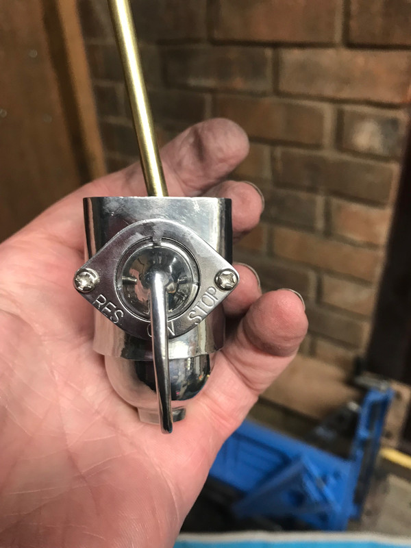

Been doing a little work on the petrol tap from the second hand tank. Just mucking about really, tidying the tap up, what started as just a little tidy up ended up being a bit OTT to be honest, let me be clear this is NOT polished, I don't intend to polish it, I may polish the lever if I feel like it. This has just been dismantled and sanded using the little abrasive discs from Amazon, anyone can do this. What started as a pretty rough casting has slowly been sanded, started with 80 grade disc, just to get rid of most of the casting marks, then progressively down the grades, 120, 240, 400, 800 and finally finished with 1000 grit disc, light green to be exact. At each stage it got shinier and shinier, however the last 2 grade discs were contaminated with buffing soap and this transferred itself onto the tap and in the end I needed to clean the surface with some Brasso felt wool, which to be honest dulled the surface down a little.
Anyone can do the same, all they'll need is a set of discs and a Dremel. I have replaced the 2 small screws holding the lever plate in place with some stainless ones, you could of course replate the originals instead or even just use the existing ones but they will rust.
It's not really that visible but I feel it looks better than that dirty grey look is normally has.
The only worrying thing is that I reinstalled the doughnut washer behind the lever, mine for some reason seems to be made of cork not rubber, it doesn't seem to be sealing as I can still blow down the brass tube with the lever in all positions, saying that the cork doughnut isn't in the best of conditions so that may be the reason.
When I get round to assembling it back together I intend to replate the plate with the markings on so it doesn't rust.

« Reply #5 on: January 22, 2023, 10:59:27 PM »
oh crap now i need to polish something else!
Re: CB750/500 petrol tap renovation
« Reply #6 on: January 22, 2023, 11:22:14 PM »
Thats ace Ken, well done mate.
I'll send you some new finger tips up in the post, that lot look knackered after making such a great job of that. ;)
  • Posts: 4830
« Reply #7 on: January 23, 2023, 12:35:46 AM »
TBH Roo the garage was so cold today that my fingers were numb, the dirt is residue of the buffing soap. The tap was easy to do, just took me a few hours. Not 100% sure if the 550 tap comes apart but if it does it should also be an easy job to do.
« Reply #8 on: January 23, 2023, 10:21:45 AM »
The King of Bling has been at it again. Nice job on the tap Ken! Only a few hours! 🥵🥵 I’ve gone for shabby chic on mine.😉

« Reply #9 on: January 23, 2023, 10:46:20 AM »
That looks great Ken,
When you say 'blow down the brass tube'. Do you mean the long one?  Air will always have an easy passage down that as it comes out of the reserve drilling lower down (also known as the R's hole  :))

Ken, never seen a cork tap seat, suggests a home brew idea. I have turned the Honda rubber ones over before now as the sealing holes have a raised lip that wears away.
  • Posts: 4830
« Reply #13 on: January 23, 2023, 04:07:08 PM »
Noticed that Bryan, I'm going to buy a genuine and see if that seals up the brass tube. I seem to recall that when the tap is shut it's supposed to blow anything coming down that tube as otherwise the tap is in effect constantly open. We'll see when the new seal arrives. I repaired the bowl as well BTW, it was totally rounded off by some ham-fisted amateur so I filed flat spots on it until it looked like a nut again, you can see the corners aren't as crisp as they should be. I'll buy a new bowl as well and keep that for a reserve.
I'll also measure the new doughnut seal and see how thick it is and have a look at making some replicas in Viton rubber. The back of the lever is smooth so a little silicon oil or grease on there to help it slide should stop it wearing as fast as well. If it seals as well as the original one I'll make a few and sell them on. £7 for a little rubber that TBH is no longer suitable for modern fuels is a little expensive.
Yes, Ian I did mean the long one, as above, pretty sure it should seal when the taps closed but it could be leaking past the doughnut seal, saying that, I've just remembered I have a new tap somewhere so I'll test that and see. Got the money Ian, lever in post later today hopefully or definitely by tomorrow at the latest.

« Reply #14 on: January 23, 2023, 04:22:38 PM »
I was correct, when the tap is either shut or on reserve you cannot blow down the long tube. Just checked with my new tap.
