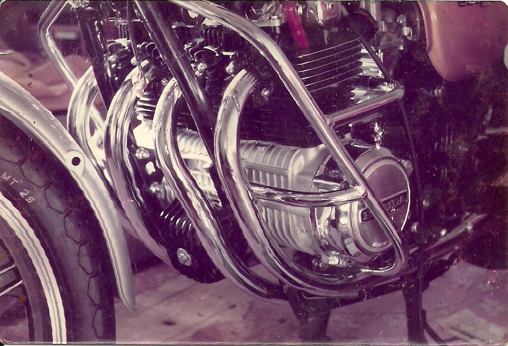

I use https://www.stainlessmiddleton.co.uk/ for my stainless as they are highly polished with no writing on top of the bolt head, he also does 12mm headed 8mm bolts instead of the more normal 13mm head. Same for 10mm, he also does 14mm headed bolts instead of the usual 17mm. Don't forget, if in doubt measure pitch first or ask for advise on here.
You can see the modern Honda bolts used in this pic, on the generator cover and also on the camshaft cover.
