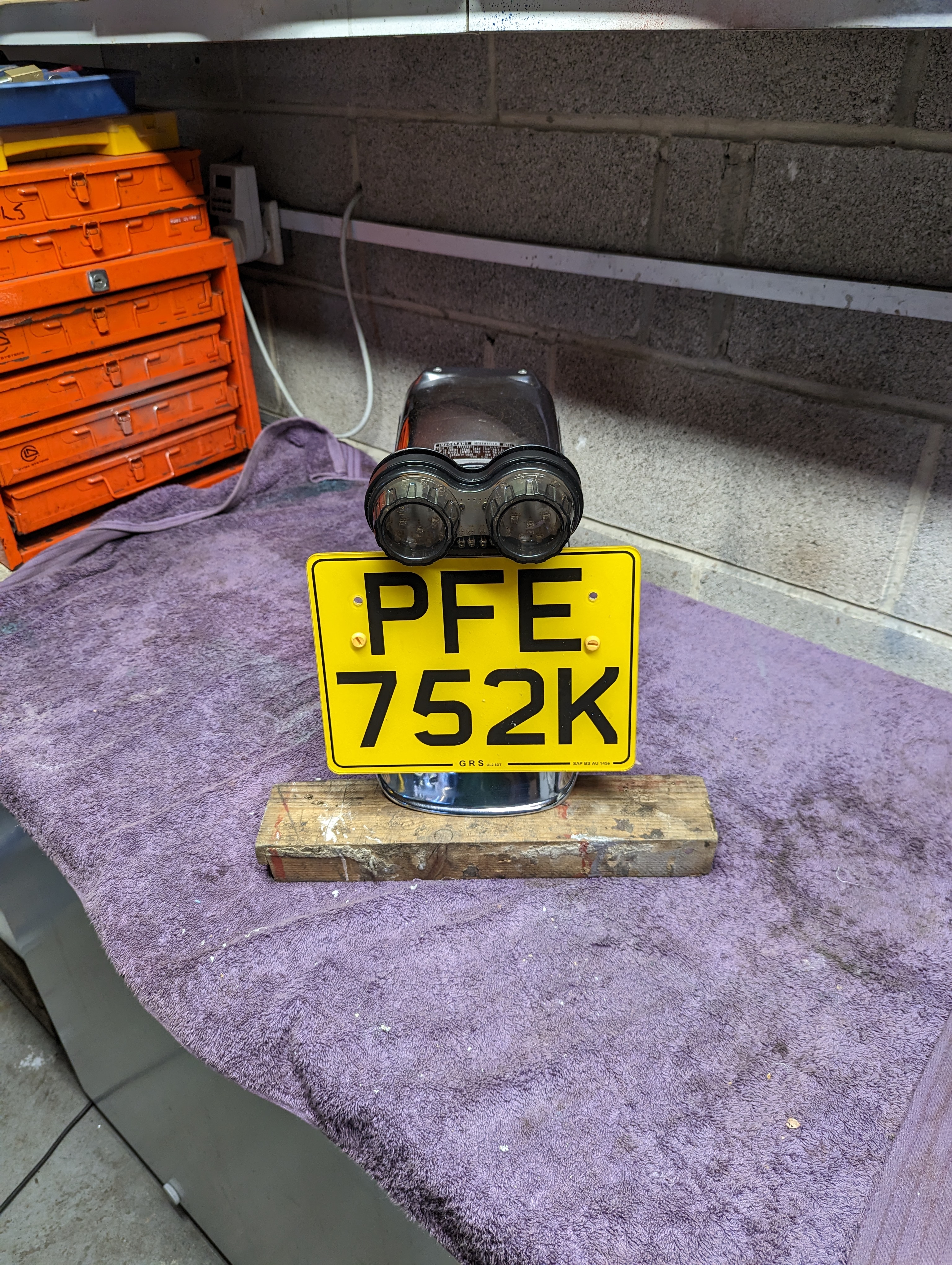

Okay I need to sort out the "sandwich" a tad better as the side view is not acceptable - but the lamp will fit!
In an ideal world a nice block of aluminium would sort out the gap between the LED lamp & the rear number plate mounting.  Aside from the cost it's a lot of cutting that would be far from perfect.
Looking for ideas such as a plastic infill block that's easier to cut. Any ideas welcome to fill the gap properly.

« Reply #8 on: February 09, 2023, 06:36:20 PM »

« Reply #9 on: February 09, 2023, 07:00:37 PM »
Or get someone to 3D print something.

« Reply #10 on: February 09, 2023, 08:28:31 PM »
Get some acrylic Perspex in black Ted, something like 10mm, fairly easy to cut and work, used to do it with lots of perspex. A few recesses for the mounting rubbers and you would be able to see anything after. Looks simple enough to do.
