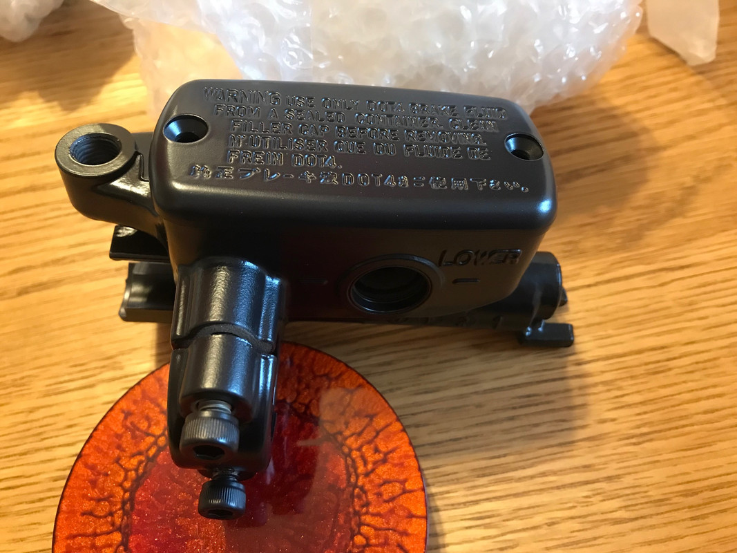

This is  a clutch master cylinder I had done recently. The cost was £10 for the body and £5 for the lid plus VAT and was done in BHK-1 coat ceramic. It looks perfect and hopefully will continue to look perfect for many years.
Just look for a ceramic coater near you. https://www.high-pressure-services.co.uk/cerakote-ceramic-coatings/

Thats the bugger, looks fantastic and means I now have to strip mine and have it done cs 'm quite jealous Iih! ;D
