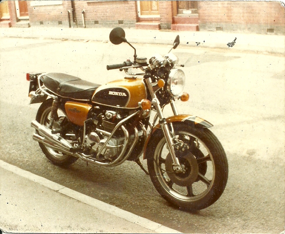

I've had 4.10 on the front and 4.25/85 on the rear with no problems. Think that's 100 and 110 in metric. I've heard of 4.50 on the rear but not seen it personally. I'd say 4.10 is about it for the front.
Not the best pic but that's wearing the above tyres.

.engine out by Macabe Thiele, on Flickr
