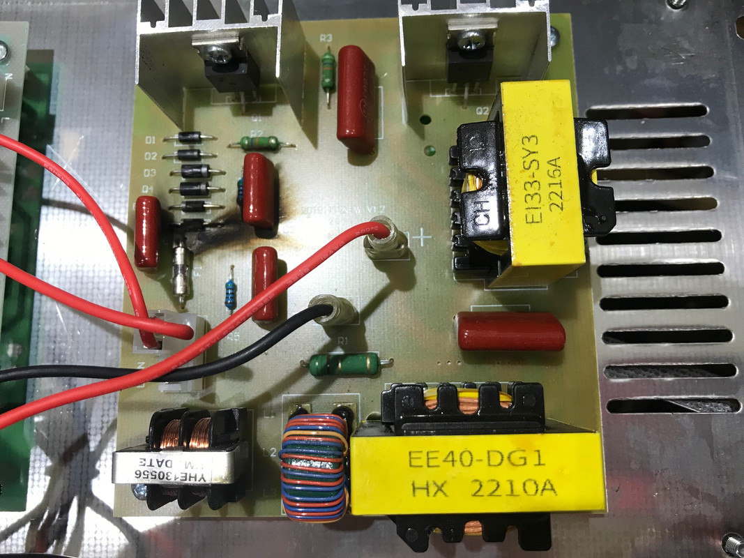

I bought an Ultrasonic bath in January to use on a bank of carbs I was restoring, used the bath twice and the last time it blew with 2 loud pops. Contacted the Ebay seller who asked me to take pics of the PCB boards, the PCB mounted fuses have clearly blown and after much toing and froing they gave me a full refund. They also stated I could keep the bath, they didn't want it back. This got me thinking, could I replace the fuses on the board and get the bath working again?
One odd thing to note however, not sure if this is the case with all of them but mine refused to heat the liquid in the bath unless the vib motor was also running, this meant it was running around 90 minutes in total and could be the reason the fuses blew. Are they all like that? This is the one I bought https://www.ebay.co.uk/itm/314275396344
I'll heat the liquid in a pan on the stove in future so I don't need the vib motor going as long.
So are these fuses available to buy, if so where and what do I look for..
I was thinking of not demounting the old fuses, just tag onto the existing wires, saves risking the PCB being damaged by excessive heat. I'm fairly proficient at soldering BTW and have quite a few different sizes and heat ranges of soldering irons.

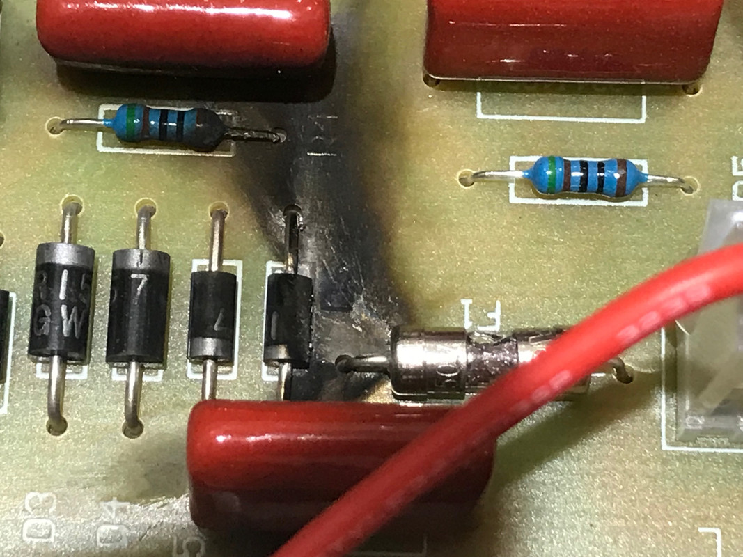

Ken,
It appears worse than just fuses - there appears to be some serious trauma around that diode (D6?) in the second pic and the solder seems to have melted around the diode mount hole and that blue bodied resistor looks suspect too. What is that splodge between diodes D7 and D9 in the first pic?
Those components are probably part of the bridge rectifier in the power supply.
Ian

Ken,
Ian
I see what you're getting at Ian. It could be that the fuse blew after severely overheating and that sprayed the soldered joint where it was mounted on the PCB across both D6 and the blue diode. I may have to remove that board and see if the back of it shows any signs of damage.
I presume these fuses are extremely low ampage ones? around 1a or something?
No mention in the literature about running it longer than the 30 minutes the timer goes to.
If I an source some fuses it may be worth the cost just to see if it works or not, if not no harm done, if it does, free Ultrasonic.
Maybe some of these. https://www.amazon.co.uk/sourcingmap-Glass-Cartridge-Axial-3-6x10mm/dp/B008LTJH1K/ref=asc_df_B008LTJH1K/?tag=googshopuk-21&linkCode=df0&hvadid=570384070781&hvpos=&hvnetw=g&hvrand=11749060324832004749&hvpone=&hvptwo=&hvqmt=&hvdev=c&hvdvcmdl=&hvlocint=&hvlocphy=1006886&hvtargid=pla-856719816406&psc=1

US cleaners are switching several hundreds of volts at very high frequency into a highly
 capacitive load and are notorious for going pop...even the Ultrawave pro units do it. The usual failure items are power transistors or MOSfets that drive the US transducers. They are the 3 legged devices on heatsinks. Best bet is to use a multimeter on  diode test function to check every diode and betweel all legs of 3 legged output devices on heatsinks. The usual failure mode is short circuit, which will show 0v on the  diode test. If you experience this then best to desolder the device and re-check out of circuit just in case another component such as a coil etc is affecting the reading.
