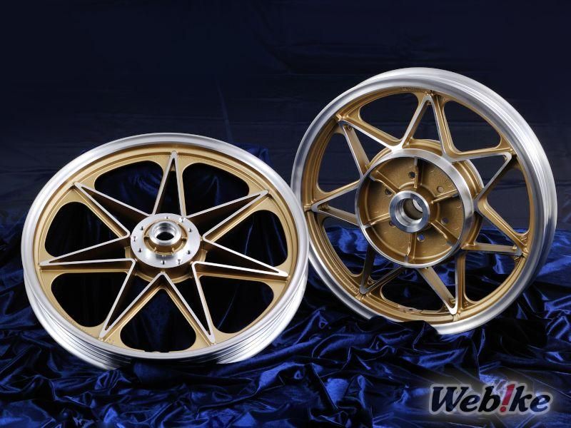

Well spotted that man on the Dresda swingarm and S&W shocks, those star shaped wheels were Japanese Daytona brand - if you fancy a pair you can now buy them again as production has recently been restarted in conjunction with Webike Japan to celebrate the 50th anniversary of their introduction in 1972...

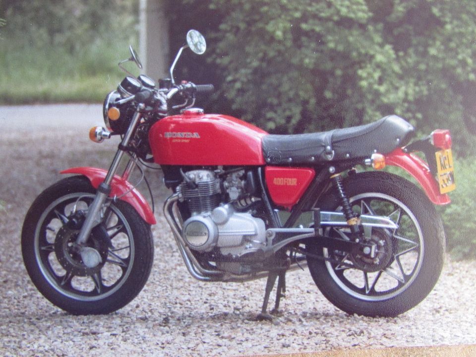

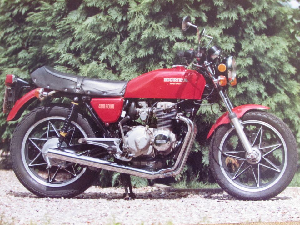

I found some pictures of the initial build of bike No. 1, before I went full cafe racer with the styling - with hindsight I almost like this version better...
Can anybody remember who made those rear footrest brackets...? I seem to think they were something Italian, maybe Tarozzi...?
