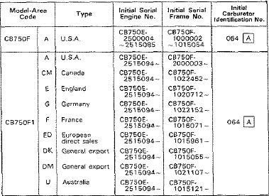

Looking at your bike it appears to be a CB750F1, initially I thought it was fitted with an F2 rear light, but a quick check in the parts manual for the F1 lists a 4 screw and a 2 screw rear light whereas the F2 manual only list a 4 screw light, so depending on where the bike was sold it could be original equipment. Here's the relevant sections of the parts manuals.
CB750F1 rear lights
This may also be handy

Thanks for your replies, the bike should be a UK one. Frame number is CB750F-1039XXX.
