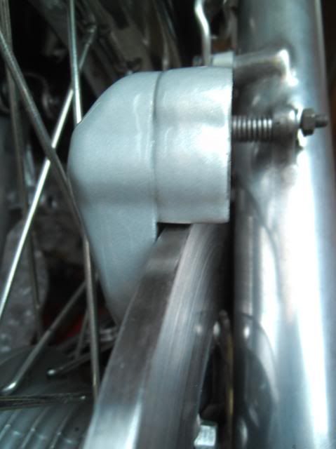

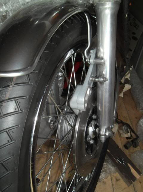

thought this would be a simple task, spoke to bryan and thought I would post some pics,
simply line up caliper bracket and mudguard and insert 2 bolts, done this first time and caliper rubs on disc as does the shield
cannot do it second time round as you have to push down the mudguard and line up caliper and put in bolts
problem is the bolt wants to go in at an angle
sure the caliper arm is on correct f on arm facing right on bike as you sit on it
so all stripped and left while I have a rethink.... it was all going to well

I have my caliper hanger sandwiched between the guard and fork is that correct ?

please be critical mate I need to get this right
let me add more info,  caliper front and rear part and arm were powdercoated, I fitted these dry as a tryout, as they were stuck together but now apart
adjuster bolt does have the spring in the middle and a washer and nut on the outside ( hard to see in pic but its there )
disc is one that came with bike as are the nuts to hold them on so obviously wrong
more research needed, the pivot arm maybe causing a lot of the problem as it does not move up and down
thanks for help please bear in mind though complete novice first bike rebuild,
lots of issues here
« Last Edit: November 18, 2013, 05:25:43 PM by MIKE550/4 »

Don't panic about the disc retaining nuts, they ARE correct, Honda changed from plain nuts and locktabs to what they called usb nuts, which your bike has fitted. They are serrated on the thrust face, so act as locknuts, no washer or other fixing required, they also fitted the same nuts to later 750 discs as well (K5 onwards I think), my 750F1 has those later nuts and work perfectly! I would suggest completely removing the adjuster bolt and spring for now, grease that pivot pin, and all should be well when you put the caliper halves together. The purpose of the adjuster bolt is to pull the fixed pad against the spring pressure, and hold the fixed pad 6 thou from the disc, but as you cannot check that measurement before the caliper is bolted up properly, it just gets in the way causing the problem you have, so put it back AFTER the caliper is together ;D

1) what happens if you miss out the adjuster bolt like oddjob (and hairygit) says ? The phots make it look like the adjuster bolt is pulling things out of alignment the way you have it set up

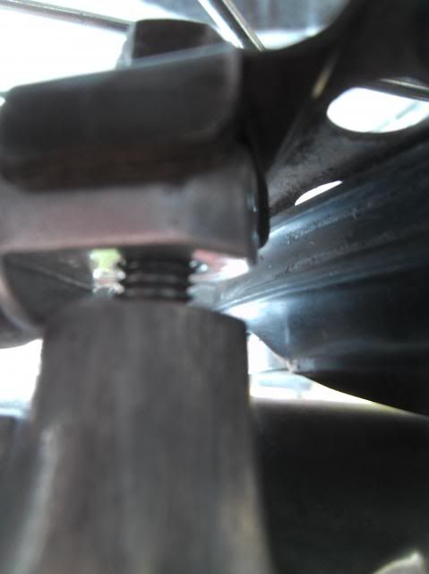

2) when you say that the pivot arm doesn't move up and down ... you mean part number 9 in the attached diagram doesnt slide up and down on part 10 ?  and thus that you cant get part 10 off of part 9 ? If thats the case , you probably need to adress that as an issue. Get the pivot pin out of the pivot arm and give them a good clean , grease them and make sure that you have an o-ring top and bottom of the pivot arm. Like oddjob says there should be no gap between the bottom of the rear pin (Part 10) and the pivot arm (part 9) ... but your photo shows a gap of quite a few mm in your third picture

exactly that it does not go up and down but does rotate, and no  o rings
so will strip, grease get correct o ring and rebuild and report back, the main problem, this should fix then

managed to get the pivot pin  out today, pin is now free, 2 orings in a recess at each end and greased and put back
hopefully now it should line up better,  the gap at bottom has now gone as in previous pic,will post up new pics later in week

« Reply #11 on: November 24, 2013, 02:34:36 PM »
so pivot pin regreased, spring washers attached to bottom mudguard and end of forks
for the bolt that holds on the caliper bracket and mudguard only room for flat washer and nut
it all seems to sit better so looks correct, also gapping on collar looks correct
comments welcome and promise I am taking it onboard  :)
