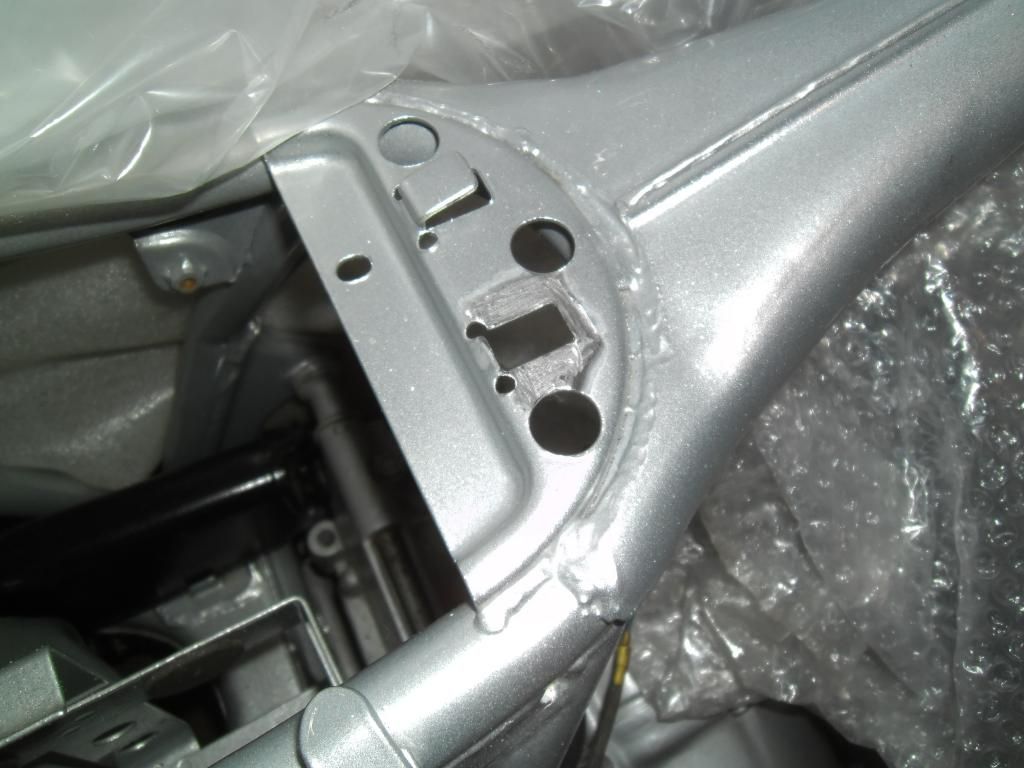

so trying to fix this tab today and got my dremel out.

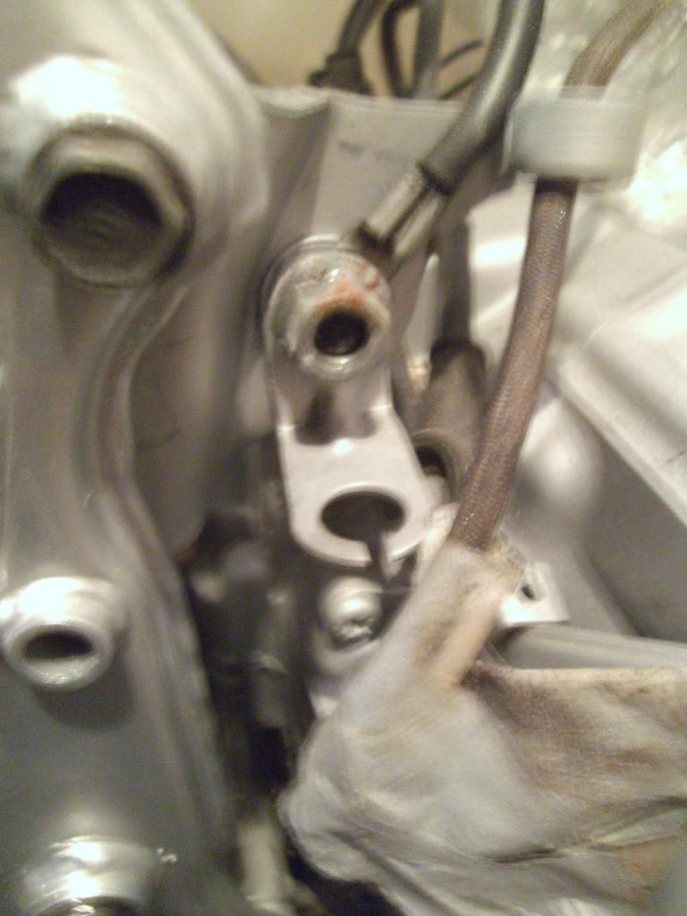

frame is powdercoated, how many earth points are on the bike?
on the tab kickstarter side is it just the tab that has to bare metal or where that tab attaches as well
also what other points on the bike have to be bare metal for earthing, dremel seems to do a nice clean job

guessing the coil mountings
rear mudguard mounting?
engine bolts ?

The earth is on the battery holder, the bolt above and left of where its at now. Put the strap on the inside not outside like your picture. The coils as stated above.

And make sure it is to bare metal, so scrap more powder coating from the frame.

Will start tomorrow..... just check battery lead is on wrong bolt ?
goes where arrow is pointing

It doesn't really matter as long as it's bare metal. And run it to the inside so it looks neater.

Originaly it does go to the engine mounting bolt on the outside as you have it BUT you need to remove pwder coat from both sides I.I where it touches the engine case and where the earth lead connects. Somewhere I have a NOS mounting plate if i can find it i will post pics.
Other earth is the small green wire by the coils and the bracket that that goes to needs to be bare as well
