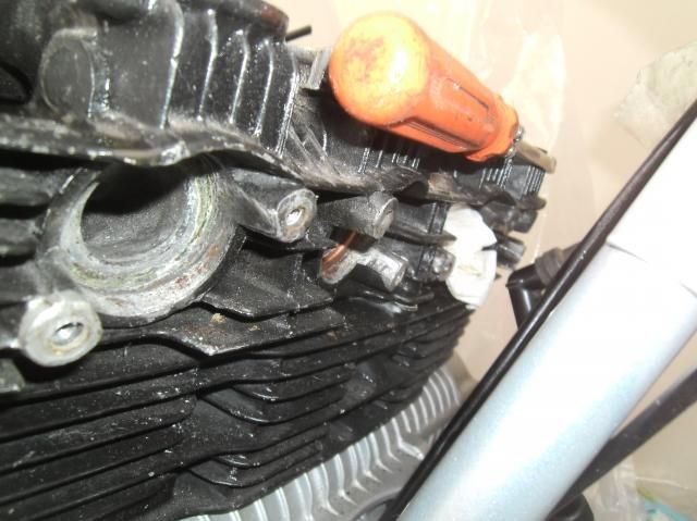

took of the 12 nuts that hold down the head, took out tensioner bolt...... and allen head bolt
now it prises up 3-5 mm and gets caught on something
anything I have missed, cant seem to see anything else

If it is moving that much, probably it is just snagging on the threads of the studs or the head gaskett is well stuck and ripping. If a bolt was still in there then it probably won't move that much. Been a long time since I took one appart.

it prises up carb side more, could be snagging on threads.... try again tomorrow

Mike, have you removed all the head stud washers? Sometimes they catch on the threads. It is also hard to remove the head because the barrels will be stuck with the head gasket.

I seem to recall this was known by Honda, if you look on the outside edges of the bottom of the barrels you will see Honda cut in a couple of slots to place prybars/wide blade screwdriver to assist lifting away from the gasket!

well head is off I think it was just catching on the threads, plus I missed one washer in the middle of the head ( recessed ones )
