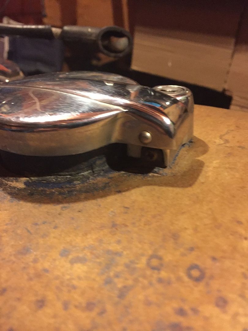

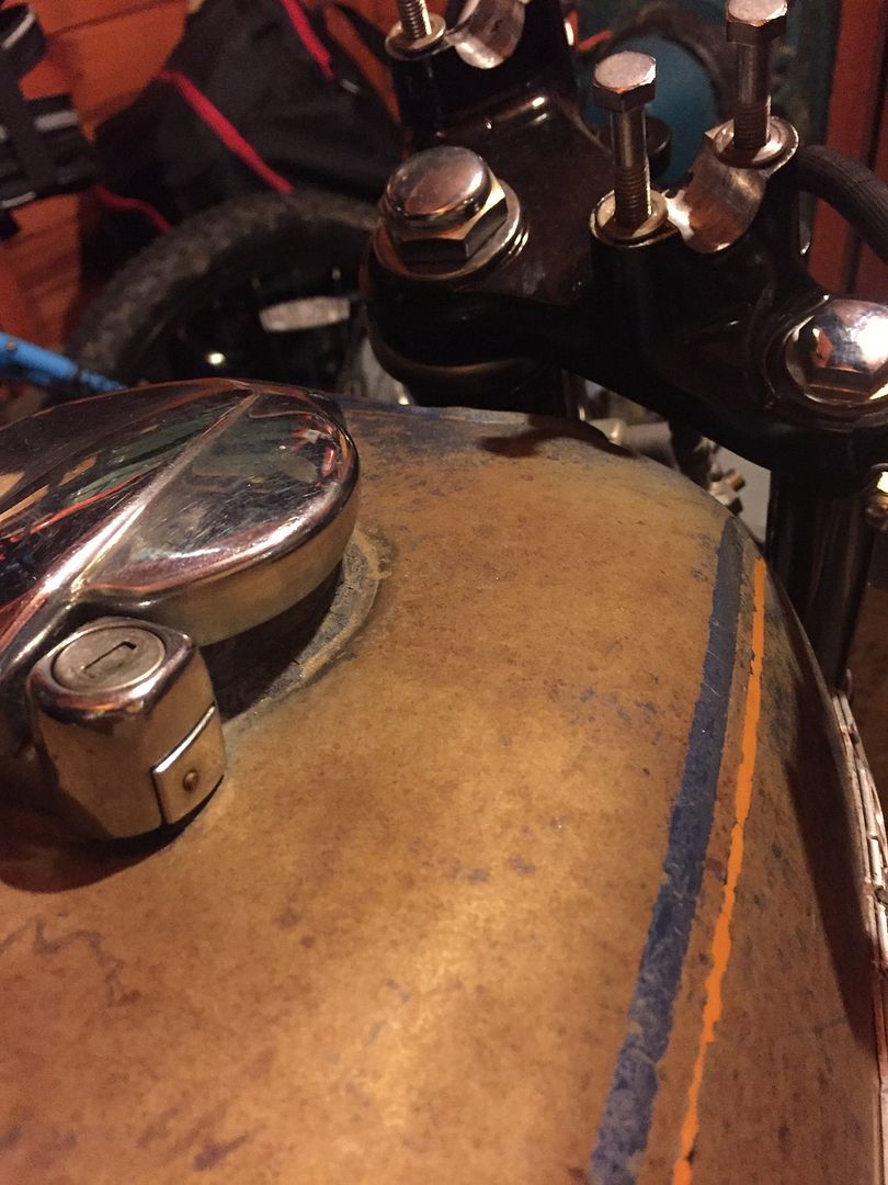

Hey guys I got a replacement key from eBay a few weeks back with the numbers from the steering lock and seat lock but unfortunately it doesn't open the fuel cap. Iv sprayed, oiled, wiggled and jiggled but it doesn't even go in the lock.
Can it be removed without damage to the tank or cap? Not bothered about the lock part as I'll be replacing it with the non lock type.
I originally thought it had been laid up due to a front brake issue as it was missing but now think that they couldn't get into the tank.
Oh yer and some bugger has rounded off the Phillips screw head.

I have opened the little flap on the lock cover and can't see anything that shouldn't be in there.
