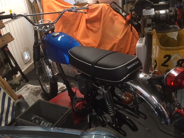

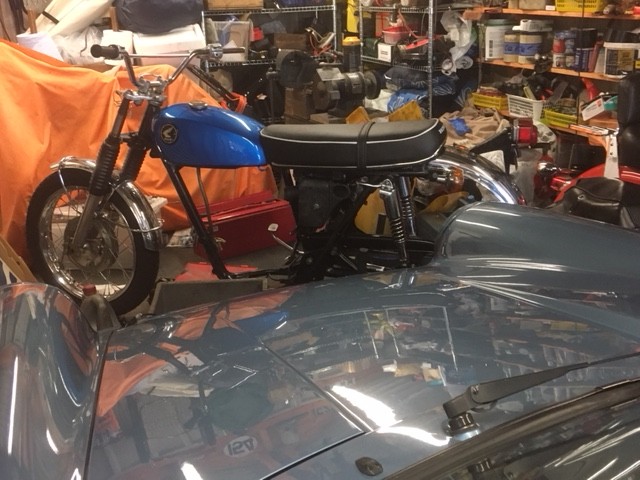

I didn't get much done this weekend, what with Marsden Jazz Festival and the PCGB's Peak District run on Sunday in the 911, but I did get the front end on...

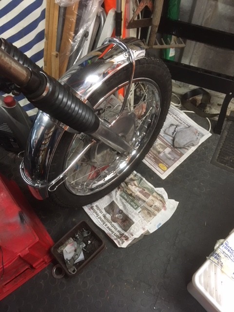

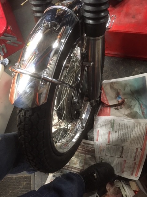

I fitted the front mudguard last night, it cleaned up nicely. a bit of dirt but no rust.

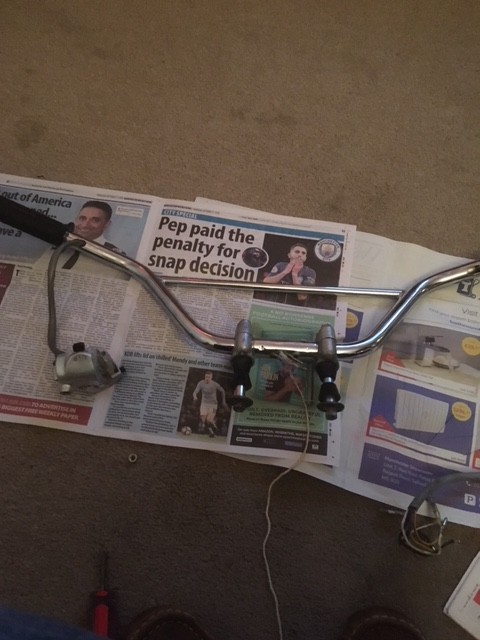

I did some fishing in the bars last night, threading the wires through after starting with a string and a nut tied on the end. After getting that though, you tie in round your wires and pull gently.
So much neater than visible wires! Early switches are nice, like most things they took a few years to get ugly.

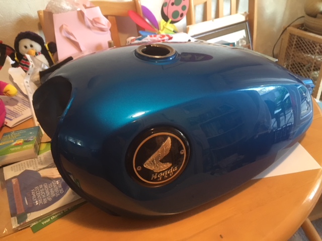

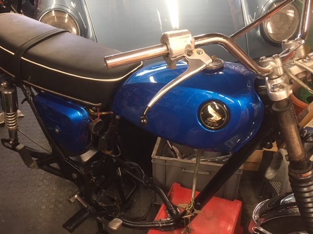

Another shot showing the seat with the tank, it came new from Texvina in Vietnam, James, its extra with the silver strip, if anyone orders, the cheaper priced version doesn't have it.
