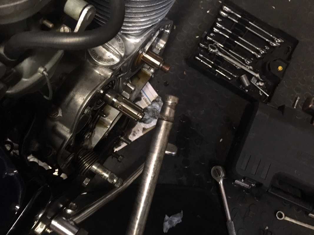

Although my selector shaft is yet to be posted from Germany, the bike is in bits ready. I also need a new shaft seal, but at least I seem to have found my oil leak at last (it was a new seal, but is clearly oily on the outside).
The shaft was in worse state than I thought, underneath the splines were practically invisible!

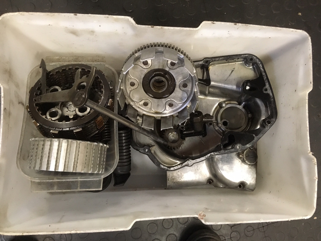

Ashley may recognize the box I'm using to keep the bits together, I think its the one he sent me a CB750 crank in. Note the condition of the clutch parts, something else that points to this bike having done a stupidly low mileage.
Here's a good tip for anyone restoring a 450, and something I'd completely overlooked. I had wondered why, when I serviced the bike that the oil spinner was cracked, so I had a close look at the oil filter rotor once I'd removed it, using the same tool as I bought to get my CB750 clutch off.. I had just refitted it straight from the parts box, it turns out it needed a serious decoke! The ledges that the outer and inner parts of the oil spinner seat against were invisible, covered by gunk from the oil that had gone completely rock hard over years of storage, and was as hard to shift as anything I've ever scraped from the top of a piston. It explains why the spinner was so hard to seat that I actually broke it trying to get it in far enough to fit the circlip.

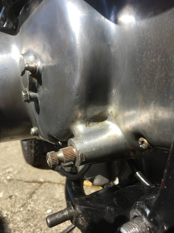

Well the shaft turned up from Germany, via DHL, on Friday. By Friday Tea Time I was out on an (essential Journey) test ride. :) Slight corrosin in patches, but nothing a polish didn't fix.
I got the verniers out and measured everything I could, as far as I could tell, the only difference between the 030 450 part and the 5T part was a different rivet where the selector pivots. The new oil seal for the shaft arrived via courier earlier in the week from CMS, It cost Eu 9 along with a new O ring for the oil spinner, the carriage was Eu14. Silvers had one of the seals on special order only and the other out of stock, so no choice really.
Anyhow, I think you'll agree this looks rather better than before. I had to use a small wedge to open up the slot in the gear lever to go over the new splines. Ash, thanks for finding me this part, really the chances of finding anything like that as NOS are getting exceedingly slim.
The test ride was a success, much easier to find neutral now, it must have been slipping around before. Nice evening and good to get out of lockdown for a quick spin.
