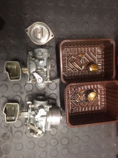

I got the carbs back from the friend who was ultrasonically cleaning them, although they came back cleaner the jets were still blocked up and crusty.
After a bit more cleaning by hand I tried to get the jets out, only to find they were well stuck, rather than chew up the soft brass with a screwdriver or damage the carb bodies  I went for the heat option with my blowlamp. I didn't get off to a good start, applying a little heat to the posts that hold the pin for the float, the solder came undone and the float fell off its mounting tab! I could try and resolder it, but I think my float height could be right up the spout if it doesn't go back exactly right, plus the seam around the float may come apart. They are available new from DS so I have ordered one. The other pin came out cold, once bitten twice shy.
I've never dismantled carbs using a blowlamp before, it was quite nerve racking, but with careful heating and selection of the right screwdrivers I managed to get the jets and drain plugs out eventually, as well as being bunged up with crud the jets aren't standard size as per my parts book, the mains are 120 rather than 130, I don't know why, so I will order two rebuild kits with new ones to be safe. Individual jets don't seem to be available from Honda so I'm stuck with buying a complete aftermarket set from D Silver.

I think my carbs are different, Ash, the kits you link to are for 1965/66 black bombers. My carbs are stamped 14H, I just went to look.
My bike, strictly speaking a K2 which has ended up in K1 clothing somewhere along the line, doesn't have springs in the vacuum pistons either. They may be missing, but there's none shown in the parts book.
There may be an upgrade kit for the K2 too, but maybe the flat spot had been fixed by '69, I don't know. Could explain my non standard jets though.

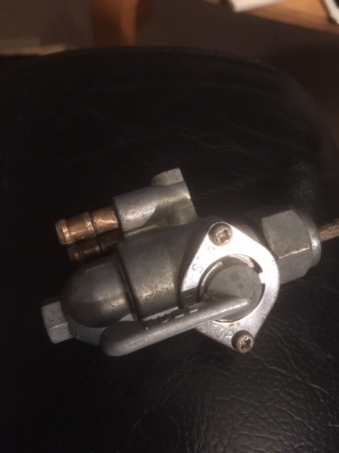

i decided to order a battery, then I can start connecting things up one at a time. I went for one of those yellow gel ones, I have one on the Harley, no problems there. I also ordered a pair of new spark plugs, the old ones look fine but its one less thing to worry about. They were all of three and a half quid for the pair, posted. How can they make them for that little? I'll still need to know about that other wire from the loom, James.
The first thing I need to do is sort out an earthing strap for the bars, which are rubber mounted, I need an earth for the starter and horn buttons. I think it goes from a tag on the bottom of the bar mount to a bullet connector at the speedo bracket.
While I was in the garage I static timed it, I couldn't get the points to close at all at first, until I tried rotating the engine one full turn, not a wasted spark like on the 750. Thinking about it, the 750 points are on the crank, the 450 exhaust cam runs at half speed.

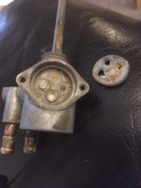

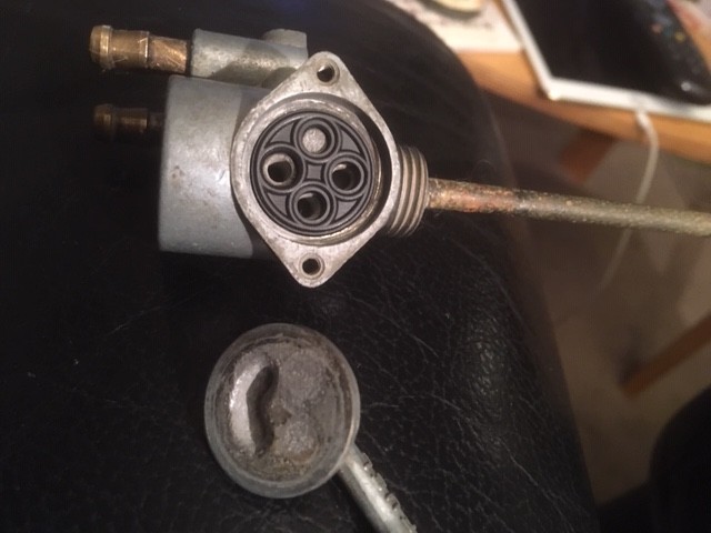

Before the carb bits arrive I can get the starter and sparks working, hopefully (I already tried the starter to get oil pressure when the engine was on the bench). As I may be in a position to try and start her up once I have rebuilt and fitted the carbs, I decided to check if the petcock was working OK, I had previously bought a genuine set of all the rubber parts and a new screen from Silvers.
Good job I checked, it was just a little bit blocked up!
I dont know what all the grey stuff was, either someone had tried to run the bike on mud, or its just what happens if you leave alloy in contact with old petrol for a decade or two. Much poking about with a long thin electrical screwdriver was needed, but I eventually dug it all out and cleared all the holes and pipe. I also had to clear out the U shaped slot on the tap, which was invisible to start with.
I finally got it so I could blow through the tap in main and reserve, and cleaned the body and face plate up as best as I could. Not as pretty as a new one, but another original 1969 part saved from the scrap bin.
