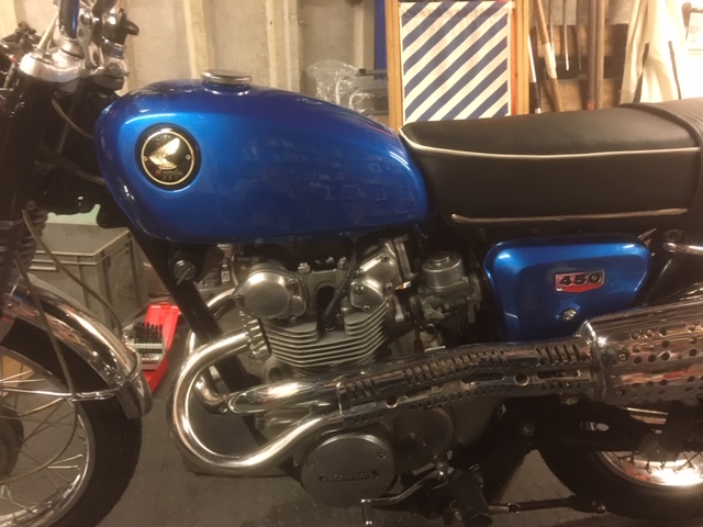

Thanks for your kind comments. Of course the advice, contacts and parts that have come via this thread have been invaluable. Once I have the clocks fitted, clutch adjusted and connect up the lights and flashers etc she will be ready for an MOT, although exempt I presume I still need one on the VIN number to get an age related registration.
Question - given that, as a US bike, there is a plate showing a manufacturing date of 11/69, do I still need to faff around with a dating letter to get her registered? I can do it via the VJMC if I have to, but I wondered if a photo of the VIN plate would do? As an aside, are Honda US any more friendly than Honda UK, who were spectacularly unhelpful with my CB750, as they didn't sell it. I was wondering if Honda USA (if they still exist) records would show which dealer sold the bike, I only know it came from a state with red soil, as there was half a pound of it under the transmission cover. There was an auction number starting with KS painted on the forks and headlamp - Kansas? Maybe Summerbud would know, if they would tell me - I guess they may want to protect their sources.
Here's a couple of phone pics of the bike ready to start with carbs and new fuel lines - the originals had turned to stone but were handy for the lengths required. I tried to take a couple of shots with my SLR, but the lens fitted meant I couldn't get far enough away in the garage, I'll take some better photos once she is complete and out and about.
