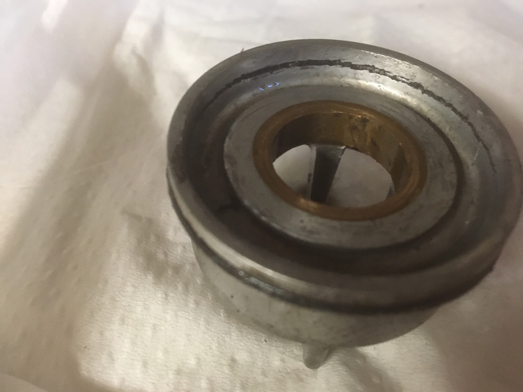

I'm giving her a first service after a year on the road. There are 666 extra miles on the clock since her return to life, so I should be able to  remember the number of the beast for future reference. I's had a bit of an oil leak recently, not sure where from but somehow the sump plug had worked itself loose, I didn't need any torque at all to move it, it was practically finger tight. That could have had a very bad outcome, something to check in the future.  :o
When I took the cover off the oil filter, I was disappointed to see that the spinner part had a crack around the top, the circlip was still in place.
 I have no idea how that could happen. The spring loaded part in the cover seemed stuck, though, so maybe that had cracked the spinner rather than retract against the spring as it should. A quick pry with a small screwdriver freed it off, I cant see how or why it had got stuck in the first place, maybe it was a bit cockeyed.
I'm off to search the net for another one, probably from a breaker as I can't see that being a normal service item, unless anyone here has a spare one on a shelf somewhere?
« Reply #280 on: March 01, 2020, 06:46:37 PM »
Might be worth checking part numbers as 250/350K twins had a similar filter
« Reply #281 on: March 02, 2020, 02:28:30 PM »
CSMNL had just one in stock, at a reasonable eu20, but the postage is (as usual) at least that, I also ordered new O rings for the sump plug and oil filter while I was at it.
DS also listed the part, £65 plus P&P!!! Feck that.
