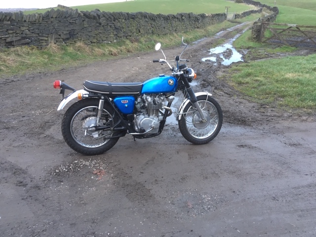

« Reply #242 on: February 18, 2019, 06:40:03 PM »
Up and running, but still waiting for a number plate to be made.
She wouldn't fire at all yesterday, I realised I'd flooded her and took the plugs out to dry, today I found still no joy, the offside plug wasn't sparking at all. A switch to the original plug she came with sorted that out, so BOTH new NGK's have failed, I got them cheap as chips off eBay and wonder if they might be fakes? She is now back on the original plugs that she came with! It reminds me of a lad I used to know with an RD250, his pockets were always full of spark plugs as he kept fouling them. Can anyone point me at a reliable source of NGK spark plugs?, I don't mind paying a little more for the guaranteed real thing.
Anyway I got it running, and took her out for a first ride, down a local ancient dirt road that has had no maintenance since the middle ages, but noone has told satnavs yet. You occasionally meet the odd stuck wagon with a very flustered driver.
The bike went OK, a bit of a handful on the really rough stuff, and the carburation isn't quite there yet. I may get the carbs off again (a real ball ache as you have to take the tank, side panels and air filters off first) and use the carboard float lever tool (I have a drawing in my Clymer manual) to get the float levels better than my trial and error setting, . At one point she cut out completely and I coasted to a halt, it turned out that the low tech bent piece of metal that rubs on the choke lever needs tweeking, as the choke had vibrated to fully on, killing the engine.
When I got back, with the bike up to temperature I got the screwdriver out and adjusted the tickover again, I was quite pleased with the result:
https://www.youtube.com/watch?v=syREwh8kUys

« Reply #243 on: February 18, 2019, 07:20:14 PM »
My 450 would wet the plugs for fun..
I found when starting do not even touch the throttle not even a bit...let it catch on the choke then roll the throttle on...never failed...
When I sold the bike the guy called in a bad mood saying it wouldn't start....yup he had wetted the plugs..New plugs and he was away...
On a foot  note I've found that when the new  ngk plugs have been flooded they are toast and never the same again..

Hmm, having a couple of teething problems but I have put 8 miles on the trip meter.
First the indicators work fine in the garage but barely at all on the road. Either there’s a loose connection somewhere or the generic relay isn’t happy about something.
Secondly and more importantly I’m dammned if I can get a reliable tickover. I end up revving her like a race bike (mine never had tickovers, deliberately) at the lights. I have had her ticking over, see the YouTube video above, but on the road she died when the revs dropped. Today I set the float levels properly as per the book, so I can rule fuel levels out, but I buggered up the carb syncing- I had them working fine together but after I put the tank back on I realised  I’d pulled the cable ends out of the junction box. I may have to do the whole palaver of taking the side panels and air boxes off again just to correct things. I’ve tried adjusting the cables so they are both taking up the slack at the same time but it’s not right. The right carb is very sensitive to the throttle screw while the other isn’t, something wrong there.
In the end I gave up as everything had got very hot, so I was worried I’d do some damage or not get it right anyway. I’m sure I’ll get there in the end, but it was easier to get her running than getting a reliable tickover.
The dry break I put in the balance pipe between the two halves of the tank has made life so much easier, if I was still having to drain the tank every time I took it off I’d be tearing my hair out by now.
