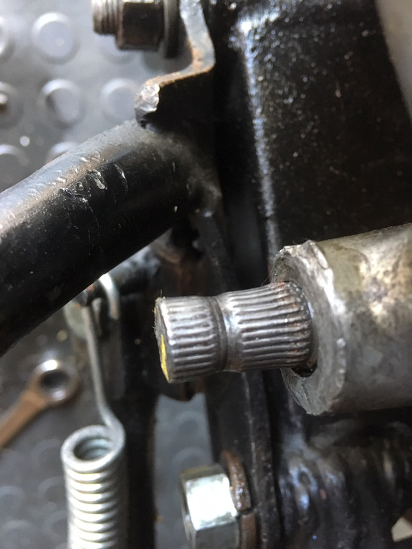

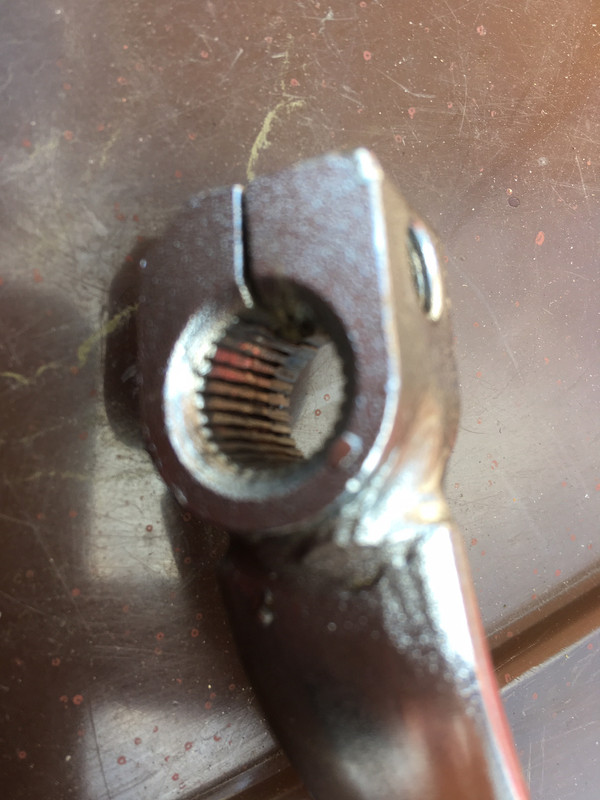

The splines on my gearshift shaft are shot, the pedal (new) is slipping on the shaft. No doubt the offs that cut a nice arc with the gear lever into the alternator cover won’t have helped.
New spindles are unobtainable, the obvious solution seems to be to open up the slot in the pedal for a tighter grip. Unless anyone has a decent second hand shaft, anyone got a better solution?

Is this one in any better condition than yours?  The teeth all seem to be intact if a little worn.  AFAIK the CB and CL mechanisms from that period are pretty much interchangeable (the part #'s are identical - 24610-292-030).
Might be worth picking up anyway for what's known as the pizza cutter selector part shown prominently in the fourth image.  Those things are the main weak point of the 450 gearshift mechanism and when they go, finding gears gets very hard.  Decent ones are very hard to come by now.
Dave - only other suggestion I thought may work would be to drill / tap a hole on the underside of the gear lever itself and use a cone tipped grub screw to provide a bit more ‘grip’ on the shaft. You’d probably also need to run a drill tip part way into the shaft to provide a seat for the cone. Might be a bit convoluted.?

Thanks for your replies. Below is a picture of the shaft, it doesn't look that bad. frankly the lever splines are in worse shape, despite it being a NOS one I got from Silvers. Clearly slipping on the shaft hasn't done it any good. Of course even just whipping the lever off wasn't straightforward, as the footrest was in the way.
James' solution looks like a good last resort cure, however I'd need to find the right screw, as well as buy a matching tap.
the-chauffeur's ebay shaft looks in worse shape than mine. It may be worth buying for the pizza wheel in the long term though, however as with all my engine internals I was lucky that my engine appears to be low mileage, and mine was in very good shape.
Of the two that ash found, the CB500T one looks in good (possibly even NOS) shape, however with a slightly different number (040) I'd need to know it fit, as I found with the oil pump 'con rod', even a slight difference can lead to unforseen issues. I may search the twins forum to see if I can find out. Not sure if he posts to the UK as the ad is all in German. The other one, there's only 1 photo it isn't clear whether its any better than mine. I don't do welding, and a part that would leave me stranded if the weld failed probably isn't a good thing to learn on, though I could pay someone to do it properly.
I'm still tempted to try and cut the slot wider, as I tightened until it closed completely, but the lever still slipped.

Sorry Dave that shaft is finished as far as the splines are concerned.
I would definitely go with the grub screw fix as a set of taps versus stripping the engine is a no brainer.
I have also fixed these on kick starts by drilling right through the lever and shaft and fitting a spring roll dowel. Worked very well and was a permanent fix and removable. Only, the rivet counters would be up in arms about a fix like that and would probably hang you.
The shaft has had it anyway so what's to lose. I know it's only a partial strip with engine staying in the frame but still a lot of work compared to a dowel.

According to a couple of posts on the US twins forum, spindles off any 5 speed 450 / 500 are interchangeable, so I’m very tempted to order the 500T NOS looking one that Ash first listed, I’d rather do a permanent fix even if I do have to strip the primary drive to do it. The part number is subtly different however the 500t one fits the CB450 K5, and so does mine, according to CMS even though my 030 one isn’t listed for the 500T and vice versa, the 040 isn’t listed for the K2.
Update: just bought it! It was 44 Eu with postage, CMS listed it at 113 plus p&p, though not in stock. Here’s hoping it fits.
The other used ones are worse than mine, and if I don’t have to weaken the new shift lever by drilling a hole in it I won’t.
« Last Edit: April 18, 2020, 02:05:47 AM by MrDavo »
