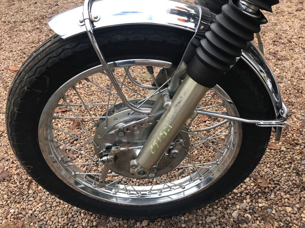

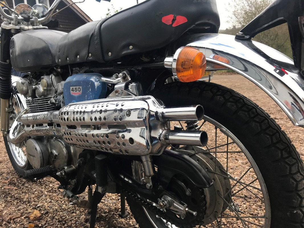

The bike turned up this afternoon, with a receipt and NOVA certificate. Mark said Summerbud was a very slick operation - 'which bike?' - wheeled into van, swap money and paperwork, thankyou, next...
No nasty suprises, other than some crash damage to the very back of the mudguard that if not hidden by a numberplate / mudflap could be trimmed off. What I feared was an acid burn to the guard's chrome started to come off with solvol and elbow grease, so a run of spilled grey paint then, phew!
A small scratch to the top of the front mudguard, other than that it is like brand new, same with the rims. OEM Japanese Dunlops, very original finish to some of the alloy, but very yellowed laquer. The shocks look original, and work.
Clean oil, compression, O/S air filter is AWOL, a shame cos they are expensive (cleanable type). I'm thinking I might buy a pair though, as if one is new and one is ancient it wont help getting the carburation right. The twistgrip is connected and moves both carbs smoothly, the clutch frees off when you pull the lever when it's in gear.
The rear heatshield is a bit scratched, I will see what the options are for getting it chromed if I could polish the scratches out. The earlier heatshield would not fit this later exhaust system, which is almost like brand new, so is staying, Uli, how much do you want for the new rear heatshield you have?
Scratching and shell damage to the top of the headlamp, incorrect speedo and front brake lever, plus the mudguard damage at the rear and front top, point to it having been wheelied right over, as well as explaining the stupid low indicated mileage if it got a new speedo out of it on an insurance claim. Both clocks are properly fitted, but from looking at photos and parts lists the tacho is the correct one, the bezel is wrong on the speedo. I could live with the non matching speedo, but if I came across the correct one I would be temped to buy it and get Marcel to fettle it, assuming he deals with these twin cylinder abominations.

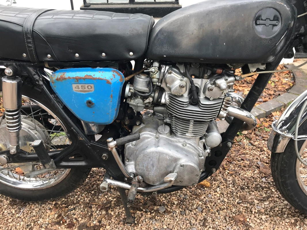

Anyway, I've owned this thing a whole week now, and the curiosity to find out what's inside was too much to bear.....
I got the head and barrels off last night, whatever mileage its really done, it's can't be a lot, and I'm fairly confident I'm the first in there, which means the internals last saw the light of day in Japan, when I was going to school on the bus, in shorts and a cap (which I was always getting in trouble for not wearing).
I was worrying I'd be in a world of stuck on gaskets and scraping and prising again, but it came apart very easily, maybe the CB750 was assembled using glue.
The first challenge was to remove the cover over the alternator rotor, so I could get a socket on the end of the crank to turn the engine over, Bubba had completely butchered the screws.
Luckily his lack of adequate tools meant that the screws weren't that tight in the first place, a couple of carefull taps with a small chisel losened them enough to get them out with a small flat screwdriver! If anyone knows where I can get an ungouged early type cover (I think CB450 is the same) let me know.
The next obstacle was grinding the pins off the soft link on the cam chain, I removed the tensioner and used lockwire attched to the kickstart to hold it clear, to give me some room without the use of fingers. I also bunged all the orices up with paper to catch any swarf.
No room to safely use the angle grinder, just as well I think, I found a small grindstone that fitted in my cordless drill instead. That nearly did the trick, I had to finish with a file when the stone broke - as it didn't hit me in the face or bounce off the 911 bonnet there was no health and safety issue at all.  ::) Luckily the drill wasn't going very fast when it happened.
A tap on the pin end with a small punch and the link came apart, then just undo the nuts on the head studs. Inside the head, all looks well:
I took the inlet cam out, hardly any sign of wear:
It must have been stored a long time with a valve open on the right hand side, that air filter was AWOL too,  what I thought was piston damage when I shone a torch down the plug hole turned out to be the carbon going a bit mouldy. There was some rust on the rings in there too but not loads, whipping the barrels off showed the middle ring was stuck, I've just sprayed it all with easing oil and left it to penetrate for now.
The left pot must've had both valves shut, it was pretty pristine.
No lip at all in the bores, I reckon they'll clean up fine. A bit of a watermark where the rings rusted though.
Finally the pistons themselves, very little wear to the skirts at the front:
But nasty scuffs at the back, whether caused by poor oil maintainance, abuse from cold (my guess) or just turning it over with crud in the bores rather than oil I don't know. However I reckon I can reuse them, its the ring seal and bore that really counts.
I can't feel any play in the small or big ends, which is a blessing. After the dramas I had with the barrel studs in the 750, despite being told to leave them alone, this time I'll leave these in if I can.
