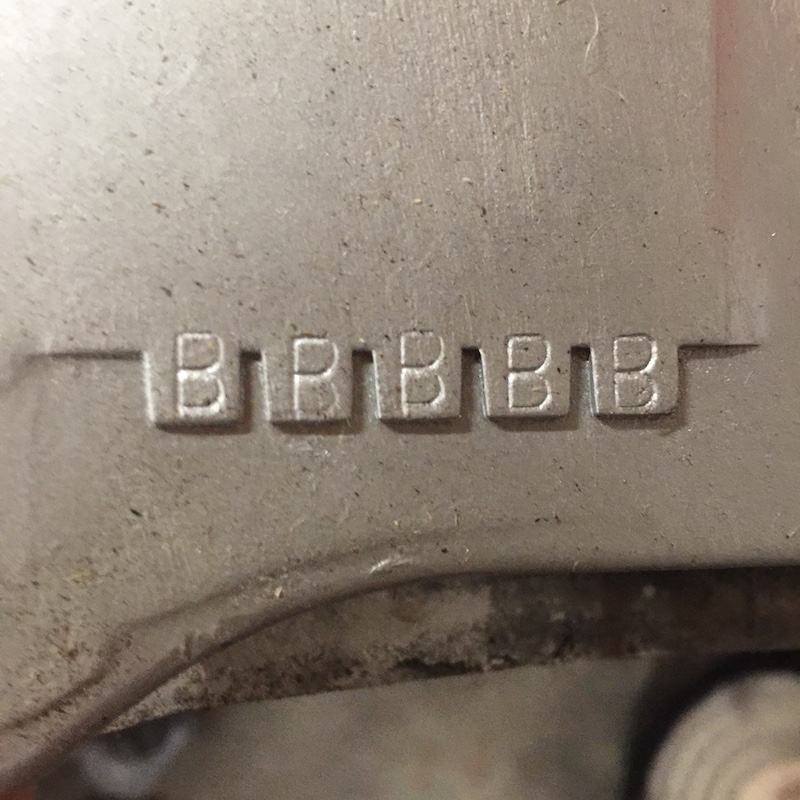

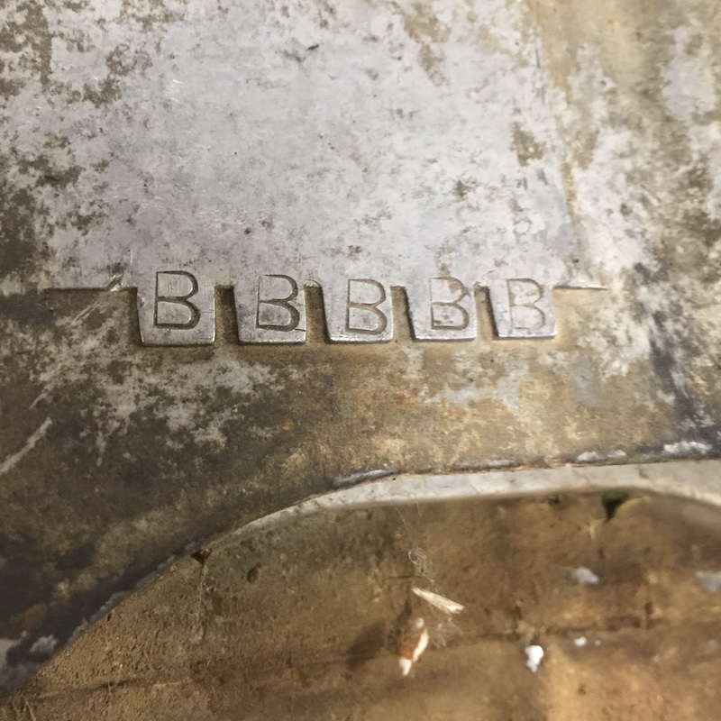

Did you compare the crankcase markings on both cases? they should be on the back of the bottom crankcase and are the journal sizes as marked and measured by Honda when it was new.
It's quite easy to get a false reading from Plastigauge IMO, too much torque, too little torque and you get a different result.
Wow thanks, I had no idea.  But I will see what I can find.
How have you measured them for rebuild or replacement if not trusting plastigauge to be accurate, enough?
"Too much or too little torque"?  Im Not exactly sure why someone would purposefully set up the torque wrench wrong when checking bearings w plastigauge?  But this is your reasoning not mine.
Again, Im just using Hondas preferred technique as per manual.
Stamped Or do you mean hand written numbers?  If so, long long gone. haha  :P
Ill look through my pics.  Maybe caught them by random chance.

« Reply #43 on: November 29, 2018, 10:35:20 AM »
Plus some people seem to think that any torque wrench is fine, like the ones which use a bending rod and a scale under the handle, very easy to misread one of those for instance.
Now your going "old school". I have one of those at work, (in the bottom of the work box". haha
Happy to find all 3 of mine are the same.
(ps, you made an old man w bad knees roll around on the cold concrete to get a shot up and under the bike. )
This is the "new case" currently installed in the bike.
Old broken case...
and my complete spare engine, saving for another project...
