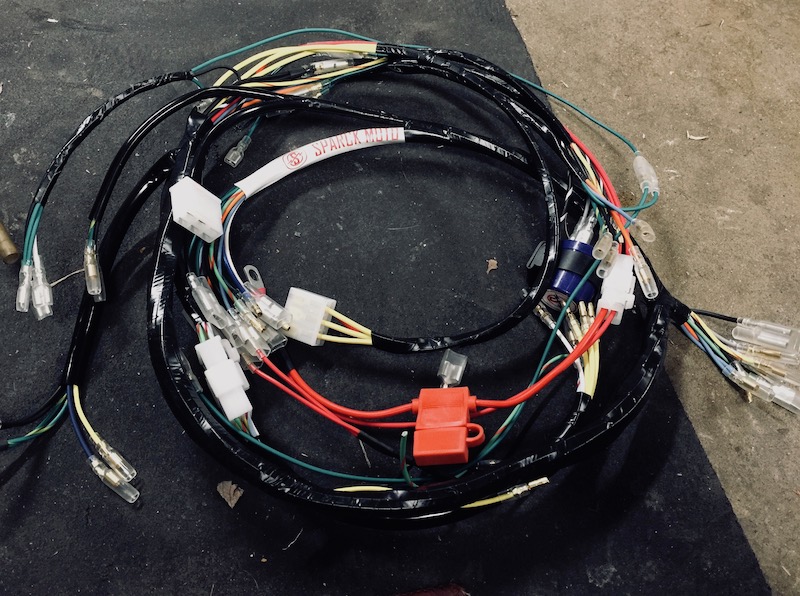

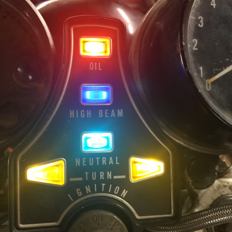

Back to the bike..

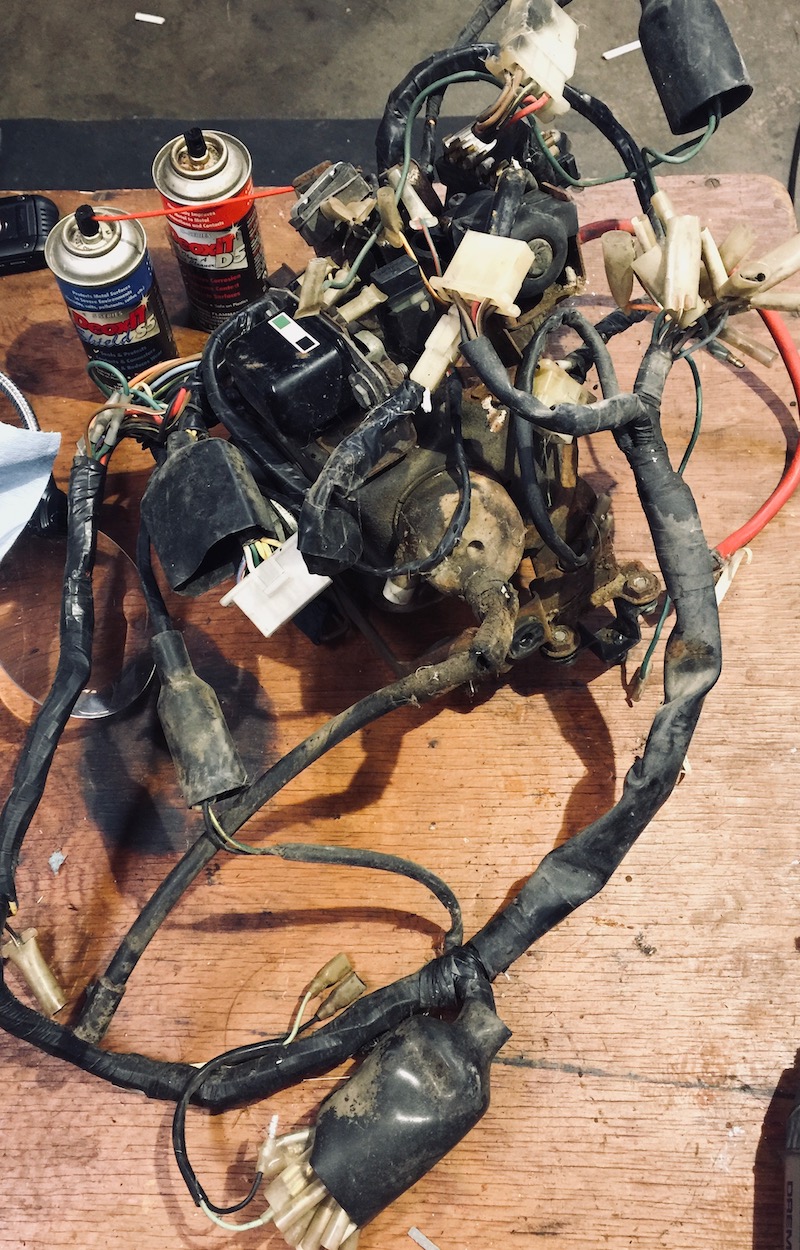

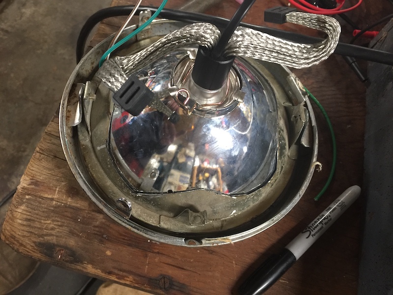

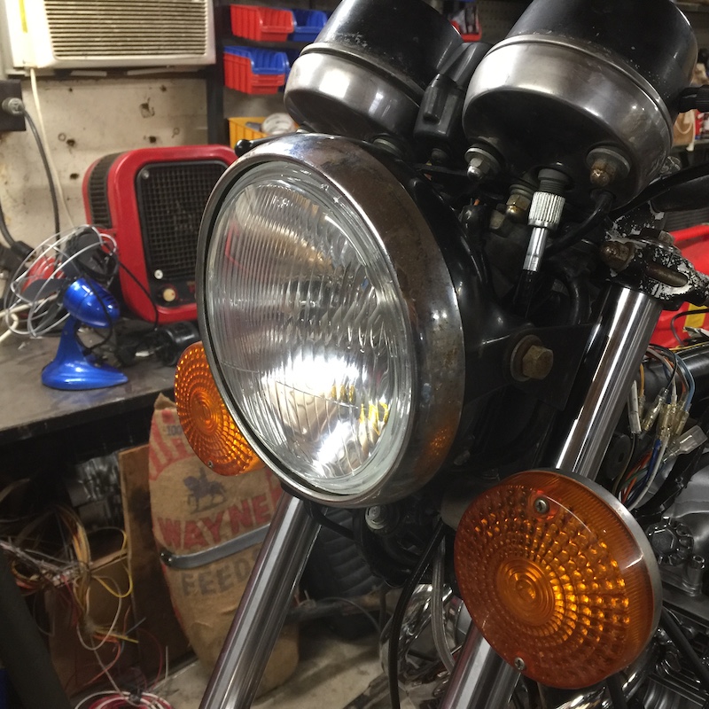

The original harness was toast, so had sparckmoto.com build me a fresh custom.

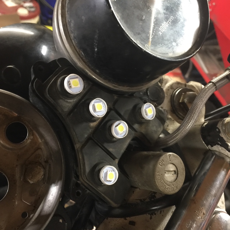

Complete w LED's, turn flasher and R/R.  Everything went perfectly.

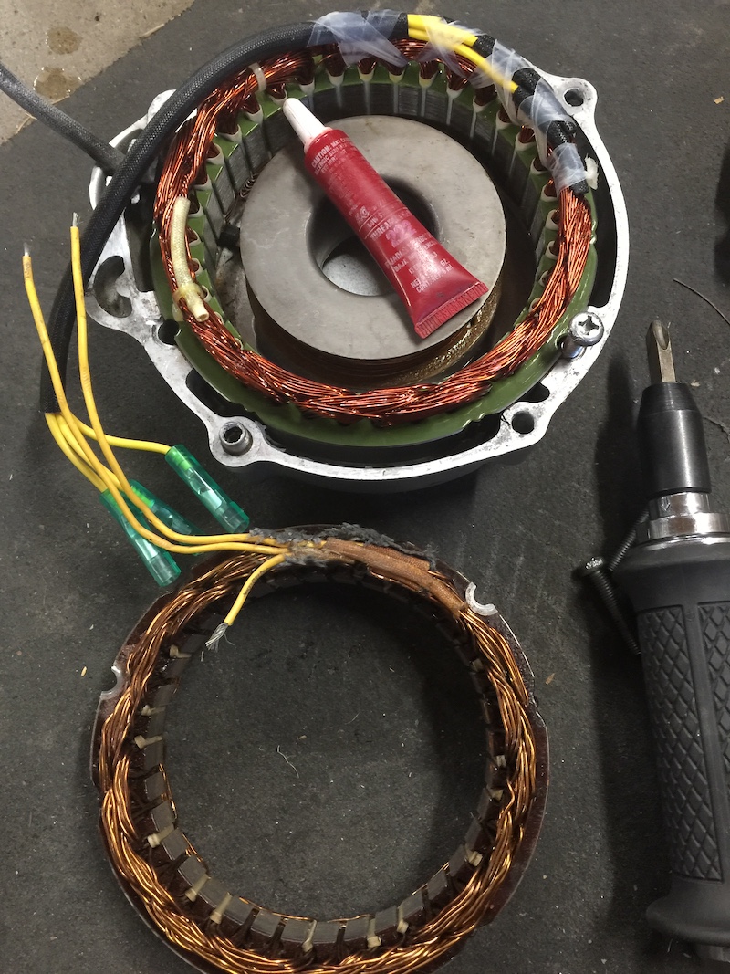

Until I found the old stator had a bad leg, got a new emgo.  and ALL GOOD
Charging 13.5vdc at idle.
Cut old reflector and riveted it to new so the original would fit in stock bucket w LED.
Charging properly at idle

Happy New loom!  8) I like the led warning bulbs. 👍

I would love to check out the original stator if you dont want ir as i have only ever seen them fail due to mechanical damage.
I’m planning to keep going w it to see if the solder joint cracked.

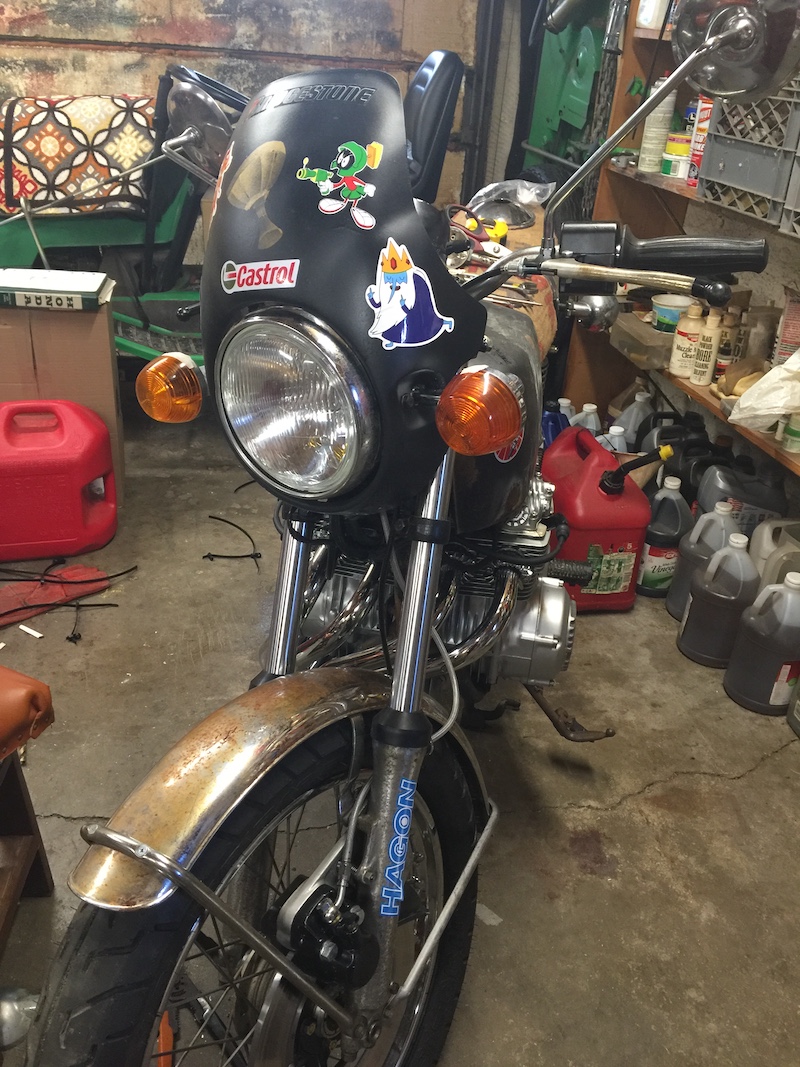

Making a few final tweaks.
Fit a British Bike fairing.  I dont recall BSA or Triumph maybe.
And a new right side cover.
