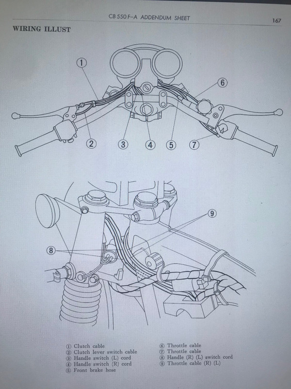

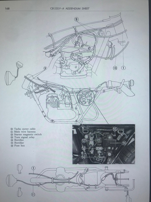

See if this works
  • Posts: 4735
Re: Teds new project a CB500 K1 mostly version 0.5 circa 1972.
« Reply #656 on: October 25, 2023, 04:00:00 PM »

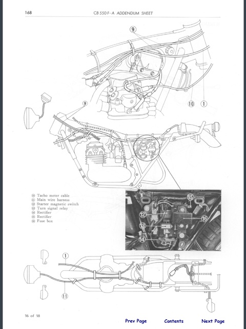

These might be better
So over the fork top on the top yoke, through the gap in the speedo/tacho bracket, round to the left of the headstock, under/over the tank mount rubber (which is odd as one image shows it above and one below, see which looks right, I suspect below as it would bend the cables less) through the gap in the frame where the coils sit and onto the carb bracket.

Thanks for the pics Ken, I saw something similar on the PDI pics for the 500. (USA bars I suspect as the throttle cables are above the clocks and feed down through that slot/hole in the bracket)
I tried to route my throttle cables through the hole in the speedo bracket as per the photo.  The cables would somehow have to get past the rev counter with not much of a gap, swooping up from the throttle grip below the bars through a tight gap near the master cylinder pipe then tight down thought the instrument bracket. They were routed better above the master cylinder but ended up part over  the rev counter.
Hence why am now as per these photos.
.throttle route 1 by Macabe Thiele, on Flickr
.throttle route 1 front view by Macabe Thiele, on Flickr
