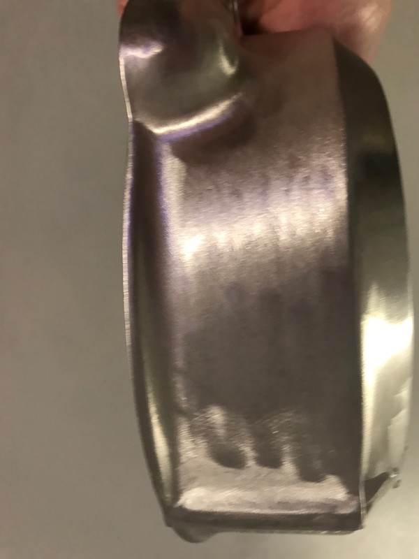

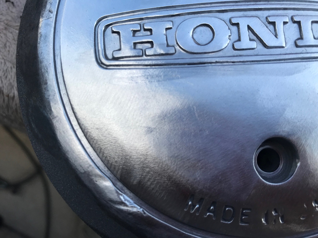

To this point I'd really been concentrating on the upper surface, it's the part most visible and the part most people see when they look at the casing area.
So now it was time to concentrate on the sides. See if the lower damage could be blended in. Again I timed it and around 3.5 hrs this time.
The edges were worked on with the aim of removing the gouges and trying to create a new edge, didn't turn out too bad at all.
Almost gone, just a few really small areas still to work on, some of them will require new engraving tools I've just ordered. These will remove those small kinks in the edging of the recess.#
The inside of the casing was pretty grubby so I thought I'd clean that up in the next step.

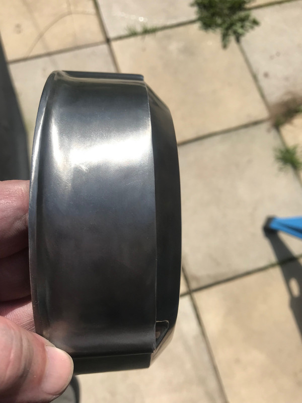

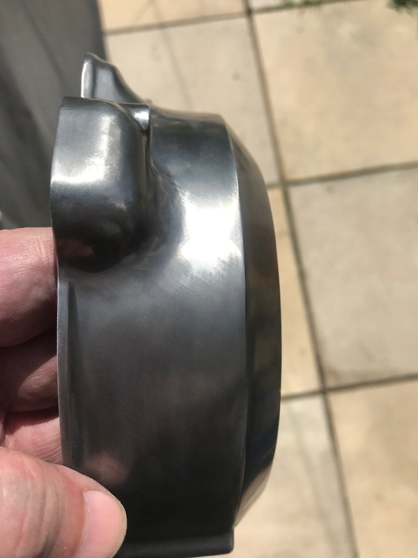

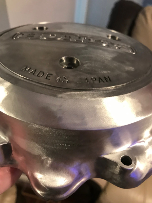

So the damage is almost gone, the sides now need some real attention, no major corrosion but there was some, especially on the upper most side, the one you see when you look down from the seat. The front edge of these casings seem to be the most prone to stone strikes and is usually the area that requires the most attention, this one wasn't really bad but there was some damage that needed sorting out.
So another 3-4 hrs of just smoothing down what had already been worked on, progressive sanding down from 40 grit to remove the gouges to 1000 grit eventually. At this time just the logo plate is down to 1000 grit and feels like a pane of glass, really smooth. Should polish up well. The sides are at around 120 grit at this point.
And here's where we were at this point.
Damage gone, just some really small points to fix when the new tools arrive.
And the other sides of the casing.

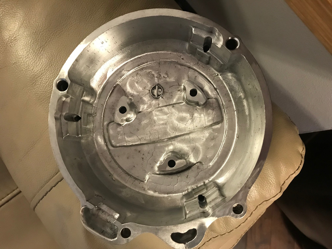

And finally the inside cleaned up.

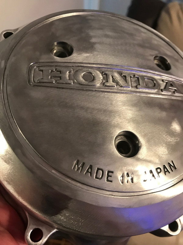

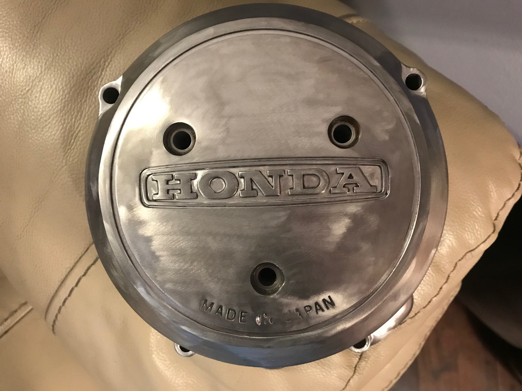

Post 5.
Didn't do much for around a week as the weather changed and I like to do stuff like this outdoors in the sunlight.

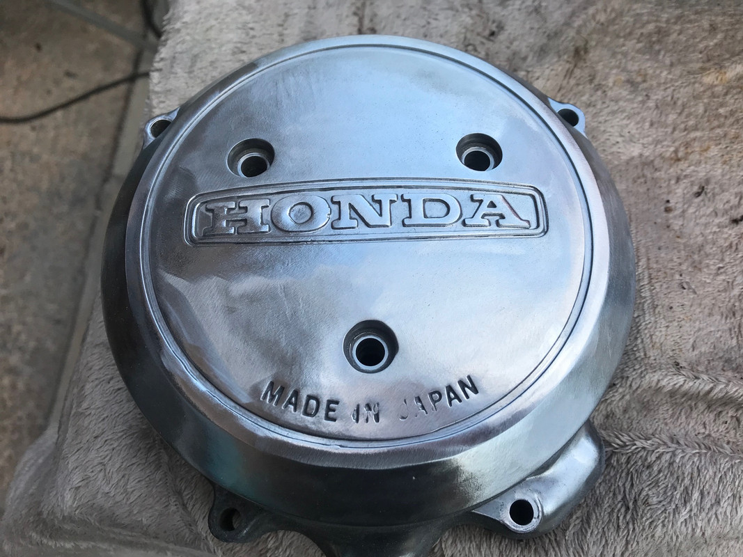

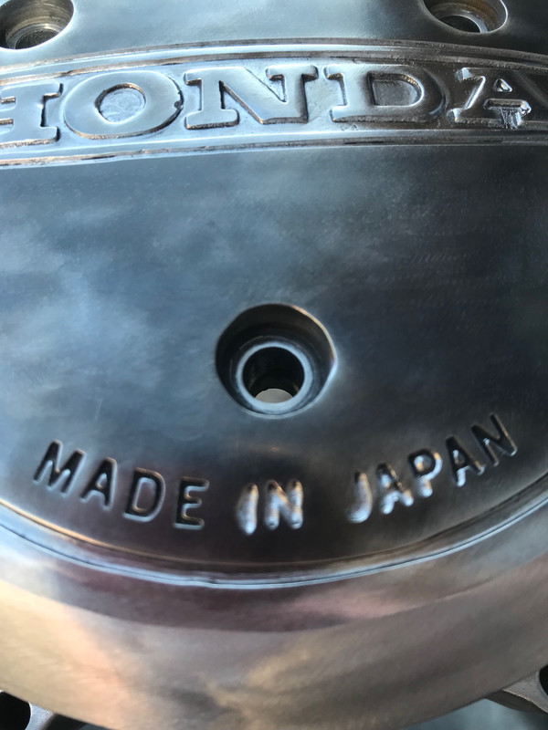

This part took me a while, there's about 10-12 hrs invested in this at the moment, this part took me another 5-6 hrs, mainly because it's this bit that determines how it will turn out, get this part right and it makes the polishing part so much easier. I reckon less than 1 hour to polish this to match chrome. At the end of this step the cover feels like it's made of glass, it's ultra smooth. I tried a small 1mm drill in the Dremel to see if I could clean out the Made In Japan engraving, it sort of worked but I should have bought the right tools for this and it was at this point I decided to buy some proper engraving tools, I'll tidy this up when they arrive, hopefully.
So here's where we are right now. After this point I'll repair all those small kinks etc, redo the logo and then polish it. After that I'll repaint the HONDA part as it was originally. I also think I'll paint in the Made In Japan part as well, I'm also thinking of painting the outer recess ring, if it doesn't look right some paint stripper will solve it and put it back to how it is now.
It's not perfect, there are numerous swirl marks left by the sanding brushes but these will go when it's polished.. There are also a small number of really small dents still, stone strike residue, I'll see if these polish out and if not I'll go over them again with the sanding brushes until I'm happy. The dark colour on the surface is actually polish coming off the edges of the sanding discs, I think they are impregnated with buffing compound and when they get hot it tends to transfer to the metal.

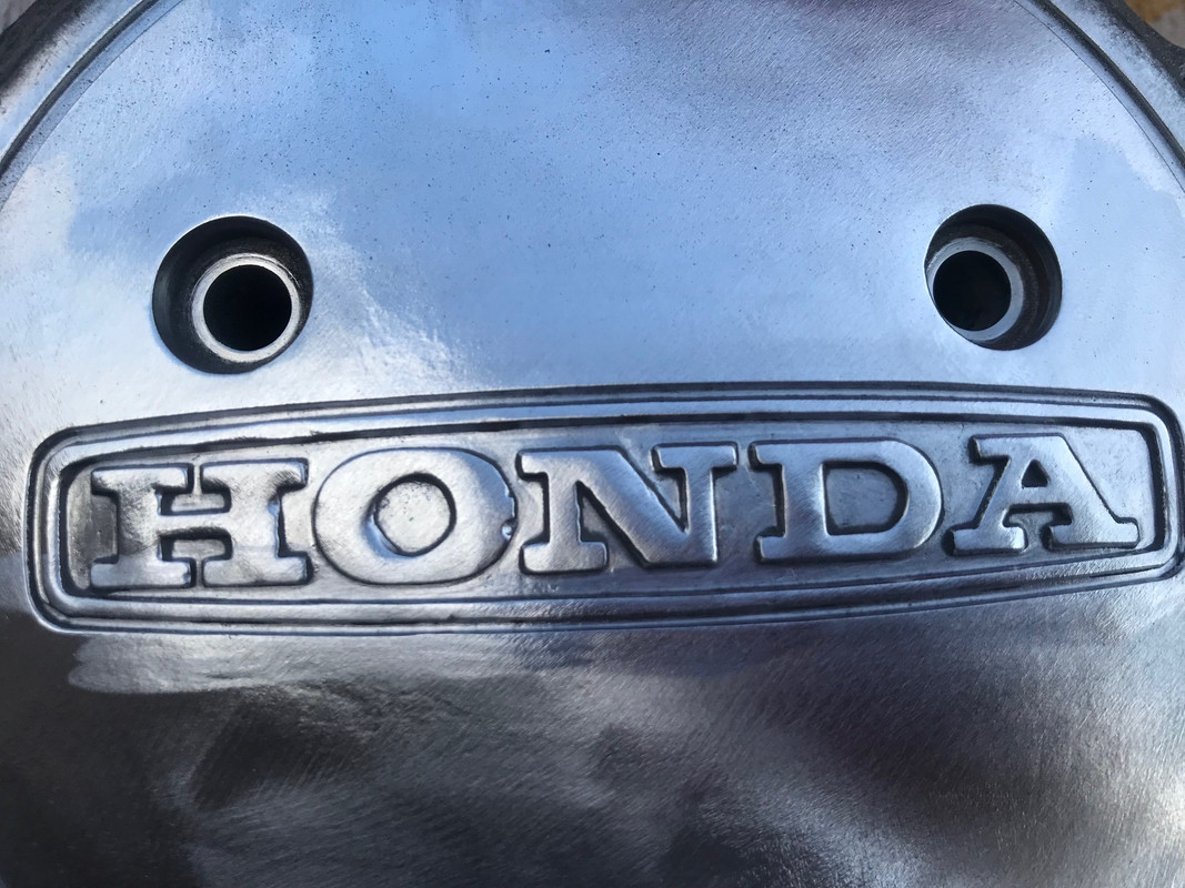

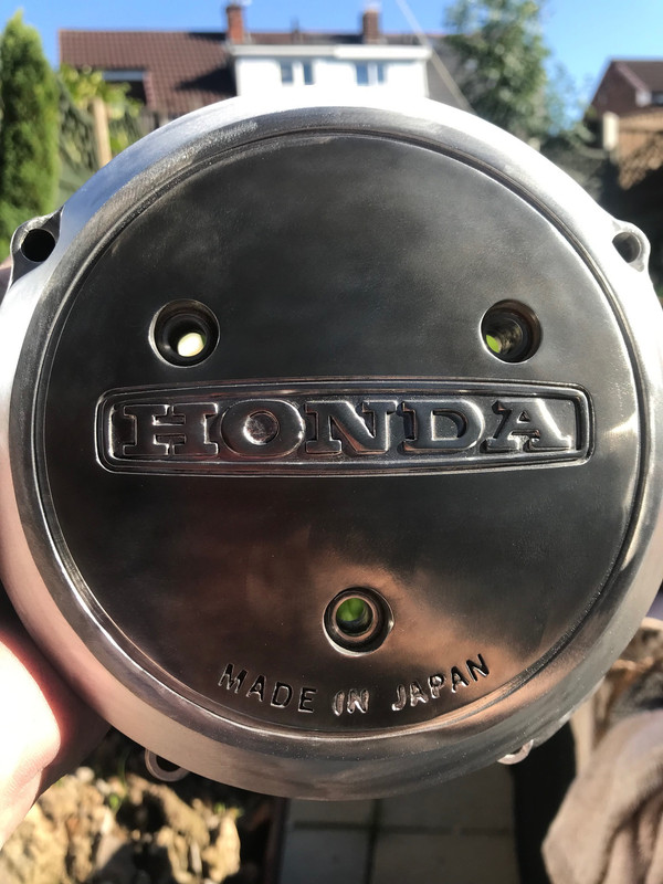

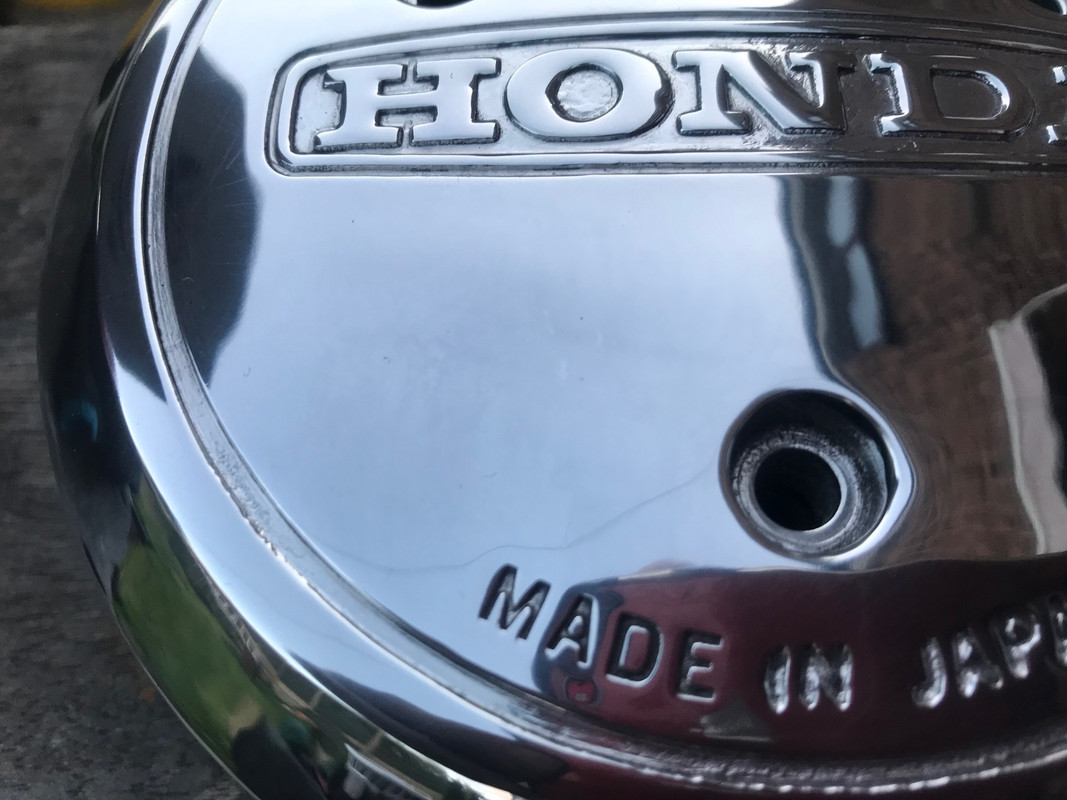

  • Posts: 4344
Re: Reclaiming an old damaged CB550F2/K3 rotor cover
« Reply #12 on: August 15, 2023, 09:11:42 PM »

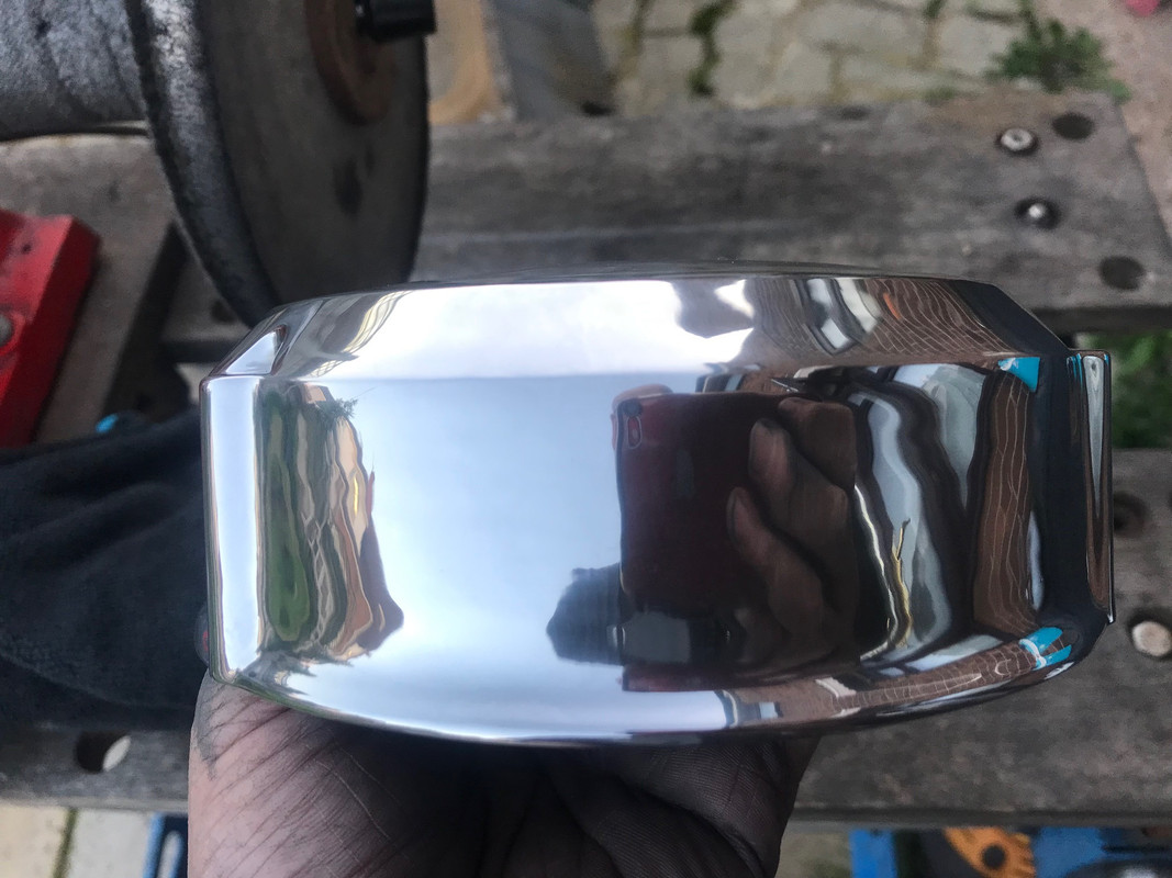

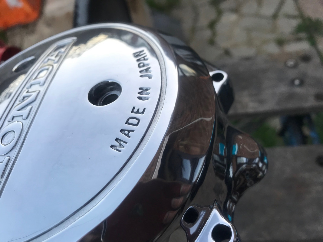

Polished the cover today. Came out ok, not 100% happy with it but I suppose it's the best it can be.
I've cleaned out all the polishing soap with thinners and I'll do the paint maybe tomorrow, just waiting for a special tool to do this to arrive. I've cleaned up the engravings as well.

That's a bit more than OK Ken it looks fantastic, it's got me thinking though, my 550 must have a 500 cover on it.
