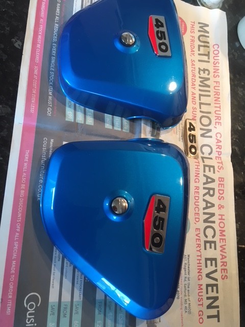

Well we've been at this for nearly a year now, the first photos of the bike as delivered are dated 16 November 2017. I never wanted to finish it too quickly, as a man needs a hobby, I'd only go and buy another project ( classic VW camper van anyone?). However it is 50 next year, so it would be nice to resurrect her for her Golden Jubilee, it could even show up at Crich 2019.
I had a go at restoring the side panel badges, and soon realised that the best result I was going to get was 'less scruffy' - although the faded painted sections are recessed and therefore easy to do, the plated sections were very tatty and finely scratched.
In the end I decided that as the newly painted side panels were so nice, tatty badges were just going to let the bike down. At that point I picked up my iPad, and ordered the expensive new ones from BadgeReplicas Australia. That was Friday night, so I was quite surprised that they turned up with the postman today (Tuesday)! Postage wasn't cheap but obviously you get the service you pay for. It took me two days to get there myself. I also had constant emails updating me of progress. No taxes or duties, which was good. Cheaper badges are available on eBay, but beware, the ones sold in threes are stickers, not the same at all.
These are super quality, thicker than the originals but very nice chrome and paint. One of the originals is shown for comparison.
After that it was only a matter of time before I stuck them on. The new centre grommet and screw are from an Italian CB450 kit I bought on eBay, strangely enough supplied from California.

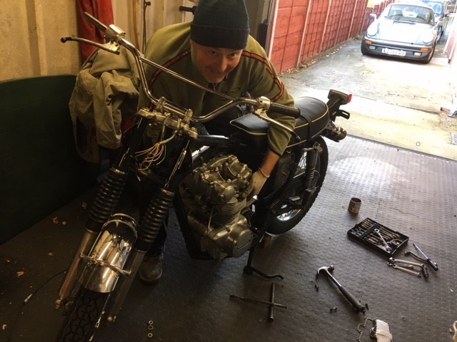

Serious milestone on Saturday, as the engine went back in!
Here is my glamorous assistant, his back was better, and I did help as much as I could.
Considering the struggle we had getting the thing out, we were both a bit surprised as to how easily it went back in. I guess learning what snagged on the way out helped us avoid problems, also I didn't bother with loads of foam or material, we decided touching up any scratches would be easier.
Putting on a load of parts now, just to see what it would look like one day when finished, just to take them off again to get on with the rebuild, would be silly, but... oh sod it!
Knowing just how good looking it's going to be will keep me motivated over the long winter nights. As good looking as any other CL I've seen, almost exactly a year since I bid on the barn find.
My mate, at 6'7" pointed out how small it all looks, I'm 'only' 6 foot, but sitting on it she feels small to me - it's a long time since I had a bike less than 500cc. The carbs have gone off to another mate for an ultrasonic bath - one was clean inside, the other full of fur.

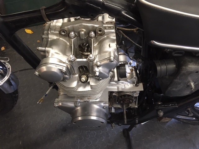

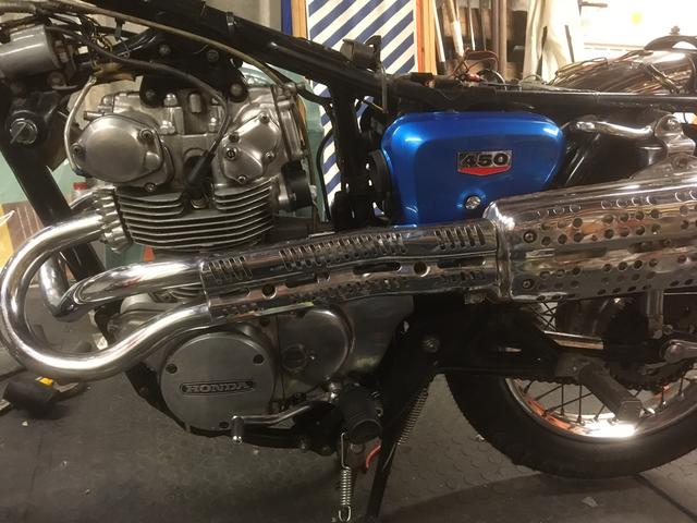

Thanks Andy. More news from the front, I'm trying to make the most of having room to work in the garage for a change, as my 911 has gone off to Cheshire Sport Classics, who are trying to find a new home for it. They sold two 3.2s last month, even though its hardly the right time of year for it. Their website has a large portfolio of photos that they took, and on their Facebook page are pictures of an ex James Hunt F1 car that they are restoring for a client, though sadly not on site so I haven't seen it yet (I think its the McLaren M26 that sold for $1.2 million a couple of years ago, the car he had his last win in). I wonder if it has an ashtray?
Although the bike looks more or less complete in the earlier pictures, that was just a rough build to see if everything fit Ok and what it would look like, the first thing I had to do was strip a lot of bits off again, but this time I'm doing it properly for keeps, so it all feels like positive progress now.

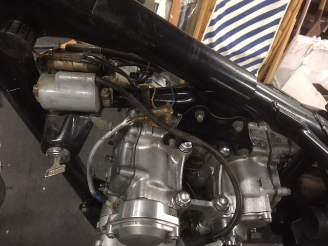

First I finished putting the engine in, there wasn't a toolbox on the bike when I got it, so I've fitted one from eBay, that came complete with the toolkit.
Unfortunately, looking in the manual I've fitted the earth lead to the wrong bolt, it should be the upper one between the toolbox and frame lug, so it will have to come off again. I had wondered about the conductivity of the engine enamel.
There is an issue with the kickstart, it works fine but there is no positive stop to stop the lever going too far forward until it touches the engine or footrest, desite a new spring. I know its not right, but as the answer will be inside the cases I think, I'll leave it for now and see if its an issue when the bike is running. If a common problem it may explain why I've seen a couple of CLs with no kickstart fitted. Its not as though I need one, the Harley hasn't got one at all, although kickstarting a 1200 twin would probably give me a heart attack.

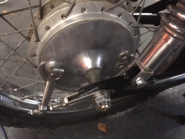

Next I decided that working brakes would help. I took the back wheel off and refurbished the brake, as it was working but sticking on. Cleaning up the spindles and reassembling with copper grease did the trick at the same time I cleaned up and polished the brake plate while it was bare.
I also ordered a chain, as once its fitted I can put the gearbox sprocket cover on properly and fit the clutch cable.

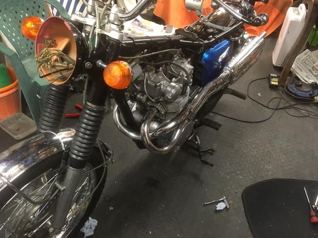

Next the front brake.
It didn't want to adjust at all when I fitted the new cable, then I realised the lever and linkage were on inside out, sadly revealing some hidden rust, so I need to do a little more cleaning and painting. All will be good in the end though, now I have a working front brake.
I haven't got the front wheel spindle in correctly, as the wheel has a little lateral play, looking just now at the parts book to see if I was missing a spacer, I see that the spindle goes in from the other side, and that hexagonal spacer is back to front, so I think that's my problem.
Finally I put the coils and Ebay'd horn on (the original was missing), and stared to connect the wiring up. Good news is that the ignition switch works and the key fits the steering lock as well, I need to get a spare cut.
The bad news is that missing from the little tag to the right of the switch is the flasher relay. It and its mounting rubber, being the same part as used on the sandcast CB750 only seem available for silly money ( an unforseen drawback when restoring a 1969 Honda), I'm wondering if I can fit one of these instead as it will be mostly out of sight:
https://www.ebay.co.uk/itm/Turn-Signal-Indicator-Flasher-Relay-For-Honda-CB750-750-C-750-F-750-K-750-Custom/113275757693

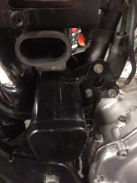

For the sharp eyed, the missing head steady nut, by the way, is the one I had to cut off before I could get the engine out, I need to remember to order one when my 'parts still needed' list is ready to go.

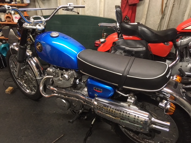

Switch lower half sorted, thanks Ashley, meanwhile here's some photos taken at the close of play yesterday. I know there are more parts on the bike in the earlier photos, but this time its not a rough build to see how it looks, these parts are on properly, for keeps, I hope.
There is now light at the end of the tunnel (hopefully not an oncoming train), I hope to be on the road in time for Crich, and of course the bike's 50th birthday later in the year.
